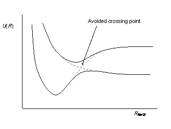

I am confused with a couple of terms usually used in the context of non-radiative transitions. I believe that I understand the concept of diabatic and adiabatic states described in
http://en.wikipedia.org/wiki/Adiabatic_theorem. The basic finding is that the coupling terms in the Hamiltonian matrix (in the basis of the diabatic states) result in an avoided crossing.
I want to transfer this finding to the case of the Born-Oppenheimer approximation, which is said to break down in the region around a level-crossing. And this is actually the point where I come across my first problem. When neglecting the first and the off-diagonal elements (closely related to the non-adiabacity operator), do I get diabatic states (case A) or adiabatic states (case B)?
If the case A is valid, the situation as depicted below would seem logical.
Here we face a level crossing, which is regarded as the breakdown of the Born-Oppenheimer approximation. As soon as the off-diagonals elements taken into account again, the avoided crossing would be obtained then.
But from my literature search I get the impression that Born-Oppenheimer approximation leads to adiabatic states. But what is the breakdown of the Born-Oppenheimer approximation then? And what are the non-adiabatic transitions resulting from the non-adiabacity operator in the last figure?
I hope anybody can resolve my problems with this stuff!

If [itex]i\neq j[/itex], the elements of [itex]\tilde{H}_{ij}[/itex] only appear as off-diagonal elements and are neglected in the Born-Oppenheimer approximation. So my question is whether the [itex]E_k({\bf R})[/itex] is already the adiabatic potential energy surface with an avoided crossing OR does the avoided crossing occur only when the off-diagonals are accounted for (which seems to be analogous to the concept of the adiabatic theorem)?
The ##E_k(R)## are already the Born-Oppenheimer PES which show avoided crossings. There is a minor distinction between the Born-Oppenheimer PES and the adiabatic ones: The latter include the diagonal part ##\tilde{H}_{ii}(R)##.
The diabatic states are obtained by looking for a unitary transformation which diagonalizes the non-adiabaticity operator for a subset of states (e.g. states 1 and 2).
Conceptually easier are the crude-adiabatic states for which the whole non-adiabatic matrix is diagonal. This is obtained by using electronic states ##\chi_k(r;R_0)## referring to one fixed nuclear position R_0.
There is a famous theorem by Wigner that even adiabatic (or BO-) PES will cross when the space of nuclear displacements is more than onedimensional. In two dimensions, this happens at a point and the PES can be shown to have the form of a conus whence one speaks of a conical intersection. Nonadiabatic couplings become very large there or singular. This is what is meant with the breakdown of the BO approximation.
The best known examples occur in Jahn-Teller systems although conical intersections have turned out to be important in almost any photochemical process.
