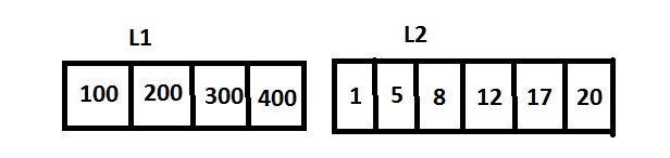

Given the following two lists:
what could we do, so that the first list contains both the elements of the first and the second list, sorted? (Thinking)
I wrote the following algorithm:

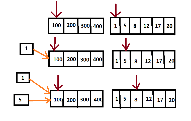

But, then it is like that:
The next fields of $1$ and $5$ point both to $100$, but it shouldn't be like that... (Worried)
What could we do? (Thinking)

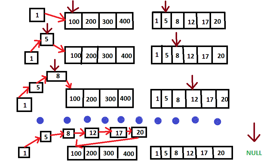

evinda said:
How could I do this? (Thinking)
Add [m]L1 = n;[/m].
Suppose you draw a diagram showing the pointers after the first iteration? (Wondering)
I like Serena said:
Add [m]L1 = n;[/m].

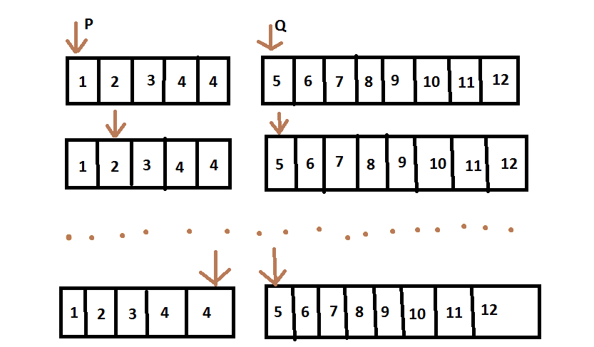

I added also an other if, for the case, when $P.data< Q.data$ and I got the following diagram:
Looking good. (Smile)
The brown arrow representing L1 should keep moving to such that it consistently points the the beginning of the list though. (Wasntme)

I like Serena said:
Since none of that code changes L1, how can the brown arrow move? (Worried)
At the beginning I wrote:
Code:
NODE *P=L1;
NODE *Q=L2;
Am I wrong? (Thinking)
Code:
NODE *P=L1;
NODE *Q=L2;
P and L1 are independent pointers.
That code makes P initially point to the same element as L1 points to.
Changing P won't make L1 change. (Worried)

I meant a case like this one:
How can we put the remaining elements of the second list at the first list? (Thinking)
