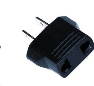

There isn't enough difference between 110Vrms and 120Vrms to worry about, IMO. And since they are rated for 60Hz, all you need to do is mechanically adapt the male plug from Mexico to the male plug from the US.
Does this look right?
http://www.expansys-usa.com/expansys-usa-mexico-canada-2-pin-plug-adapter-converts-eu-to-us-217870/?utm_source=google&utm_medium=shopping&utm_campaign=base&mkwid=svHjLhmZB&kword=adwords_productfeed&gclid=COac-rKA_7ECFSXhQgoddVEATg
Thanks! It certainly looks like what I need. I did order the plug you mentioned for 2 bucks. Let's hope it works.
The other thing I want to confirm is -- the subwoofer states the cord is a 110V power cord, but the plug itself has a voltage on it that says 250V. I should go with what is stated on the subwoofer correct? (And ignore what is on the plug itself?)
Yes. If there's a label on the subwoofer (would normally be near where the power cord exits) that says 110V then that's voltage it requires. If there's a voltage (and/or amp) rating stamped on the plug, that would normally just represent the maximum rating for the plug itself.
Thanks! Much appreciated.
