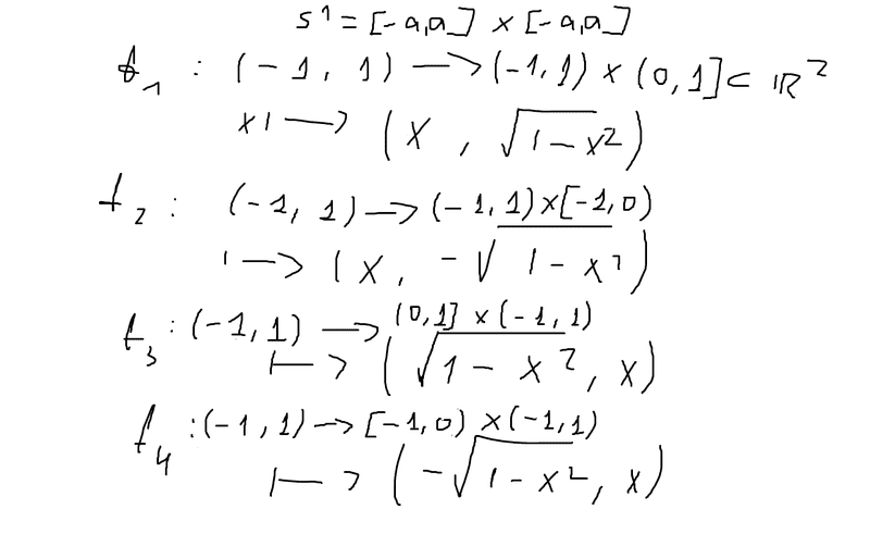

Suppose a parametrization ##g: (-r,r) \rightarrow \mathbb{S}^1 \\ t \mapsto x ## where ##(-r,r)## is an open interval of ##\mathbb{R}##.
Now define ##f_1: \mathbb{S}^1 \rightarrow \mathbb{R}^2## by ##x = g(t) \mapsto \bigg{(}x, \sqrt{r²-x²} \bigg{)}##
This function does not cover the entire circle ##\in \mathbb{R}^2##, because the points ##(r,0)## and ##(-r,0)## ##\in \mathbb{R}^2## are excluded. Also, we would need to define another function ##f_2: \mathbb{S}^1 \rightarrow \mathbb{R}^2## by ##x = g(t) \mapsto \bigg{(}x, - \sqrt{r²-x²} \bigg{)}##
Is my above understanding correct?
Yes, this is correct, but still does not show that the map is not onto ## \mathbb R^2 ##, though. In this case you can also use some topological invariants to show the non-existence of a homeomorphism.

Your notation is a bit confusing as I assume ##f_1=g## and ##x=t##. A better parameterization is simply done be the angle. You can "run" through the circle by ##p\, : \,[0,2\pi) \longrightarrow \mathbb{R}^2## defined as ##p(\varphi)=(\cos \varphi, \sin \varphi)##. This is a continuous embedding. But all points apart from the circle are not hit, so it's only injective, not surjective. A homeomorphism ##h## requires both, such that it can be inverted. In addition both mappings (##h## and ##h^{-1}##) have to be continuous.

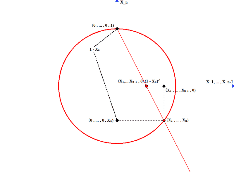

You can map all points smoothly from the circle to the line (##x-##axis): the southern half of the circle will get you the points between ##-1## and ##+1## and the northern half the points outside. Except for the northpole itself, which is infinitely far away. So you have to extend the real line by an infinitely far away point, which is called projective line (see link above). So now if the circle ##\mathbb{S}^1## and the projective line ##\mathbb{P}(1,\mathbb{R})## are topologically the same, it therefore can neither be the real line ##\mathbb{R}^1## nor the real plane ##\mathbb{R}^2##.

Thanks @fresh_42 for the explanation. It is interesting to see in details how the stereographic projection works.
