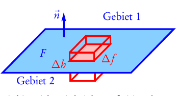

I guess with "Love theorem" you mean the boundary conditions of the electromagnetic field in matter.
You derive them from the integral form of the macroscopic Maxwell equations. Let's start from the local form. In Heaviside Lorentz units we have
$$\vec{\nabla} \times \vec{E}+\frac{1}{c} \partial_t \vec{B}=0,\\
\vec{\nabla} \cdot \vec{B}=0,\\
\vec{\nabla} \times \vec{H} -\frac{1}{c} \partial_t \vec{D}=\frac{1}{c} \vec{j},\\
\vec{\nabla} \cdot \vec{D}=\rho.$$
There are equations of the "curl type" and of the "div type". The latter ones are simpler to treat.
Take the fourth equation above and integrate it over the red "pill box". We assume that ##\vec{D}## has at most a jump across the boundary but not something like a ##\delta##-distribution like singularity. The latter may be the case for ##\rho##, if there's a surface-charge distribution ##\sigma_{Q}## along the boundary. Now use Gauss's theorem, and you get
$$\vec{n} \cdot (\vec{D}_1-\vec{D}_2)|_{\text{boundary}} =\sigma_{Q},$$
where I've first made ##\Delta h \rightarrow 0## and then shrunk ##\Delta f## to a point on the boundary. This means that the jump of the electric excitation ##\vec{D}## equals a possibly presend surface charge.
Using the same figure for the 2nd equation you get
$$\vec{n} \cdot (\vec{B}_1-\vec{B}_2)|_{\text{boundary}}=0.$$For the "curl equations" look at
