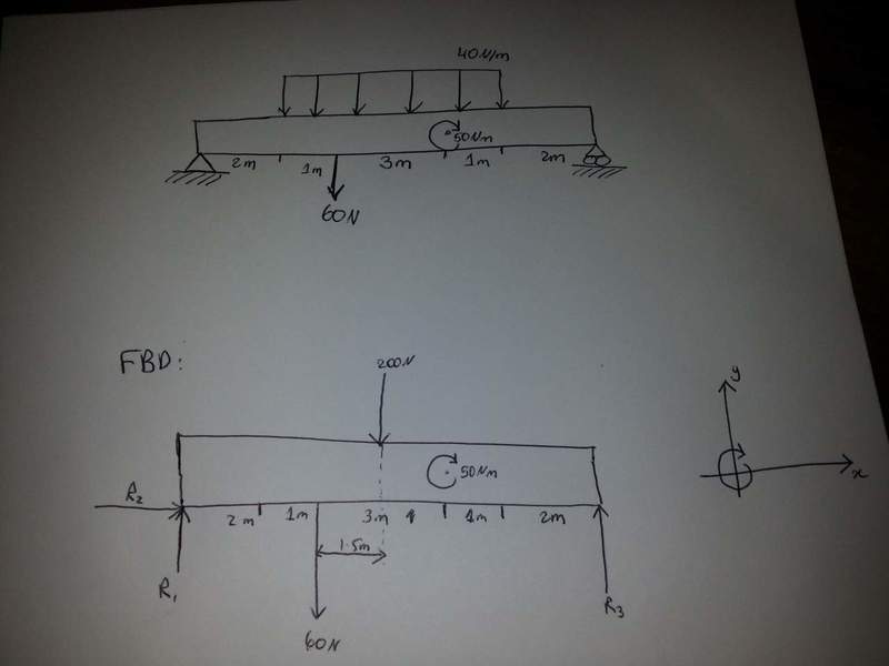

I'm trying to find the boundary conditions for the beam shown in the figure.
Notation:
V= Shear force
M= Bending moment
at x=0 V=R1, M=0
at x=9 V=R3, M=0
In the solution provided at x=9 V=-R2. I don't understand why it's negative, since I took upwards as positive.
Help appreciated!

Write the equations of equilibrium and solve them. It's not clear from your attachment if you are talking about R2 (which is horizontal) or R3 (which is vertical).
Sorry my bad!
I meant:at x=9 Shear force=R3
But in the solutions it's: Shear force= -R3
I don't see why it's negative R3.
I already have the values of R2 and R3 from the question. It's just a matter of determining the shear force at the extremes of the beam.
I agree with you. The way you have it drawn, R3 should be positive, and the shear force should be positive. Why don't you provide more details on the "correct" solution that has been provided to you?

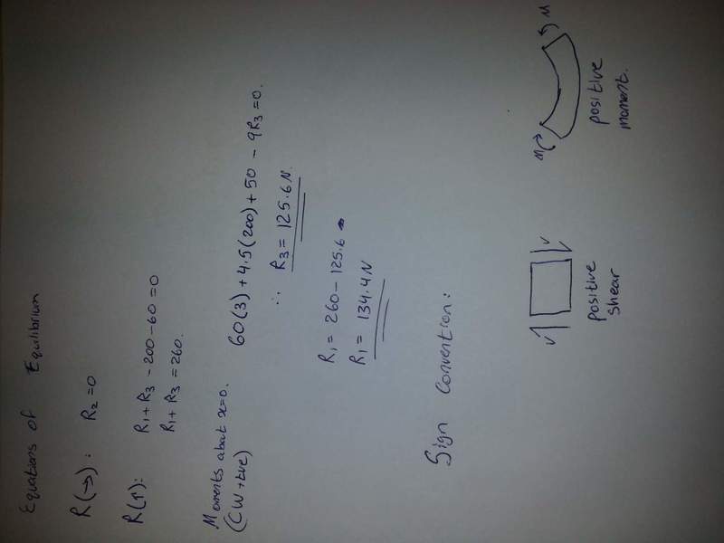

I've attached my working out.
Hope that clarifies things!
Sorry about the orientation, I can't seem to rotate it.

So, at a section say 1m from the right hand end, do you think the shear is positive or negative, according to the sign convention you have given?
I'd say the shear is positive R1 at x=1m.
Yes if x=1 m from left end. What about x=8?
Ahh! Negative R3 because the force R3 has to bring the shear to 0 at x=9.
Agreed negative but I hadn't thought of your reasoning before now. The sign convention diagram you gave us showed positive shear as "downwards to the right" of the section. But this shear force is "upwards to the right" and therefore negative. (There are other conventions in use for M and V - that's why you should state them when you use them)
