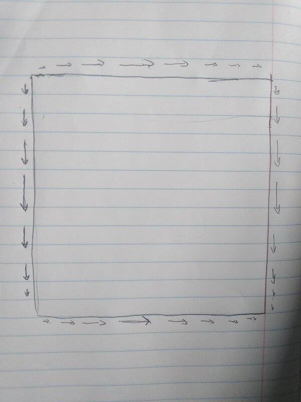

I was considering a square boundary. I hadn't thought of the specific boundary conditions yet (I was actually imagining adding objects inside the flow as another boundary and making the flow just horizontal). This is a bit of a contrived example, but it shows the issue I'm having. On each side, the flow varies parabolically, being 0 at the vertices and a maximum at the middle. It seems to me the stream function would be a constant all along the boundary and so a constant all across the region, indicating no flow whatsoever. This seems to lead to a discontinuity from a nonzero velocity at the boundary to 0 velocity immediately adjacent to it.

I'm imagining no flow in our out of the region. Say the coordinates are of the vertices are (-1,-1), (-1,1), (1,-1), and (1,1). The equations for velocity would be:
Left and right boundary: ##\mathbf v=-v_0(1-y^2)\hat j##
Bottom and top boundary: ##\mathbf v=v_0(1-x^2)\hat i##
I believe this would mean ##\psi = c## as the velocity vector is always parallel to the direction you're integrating.
I'm guessing that in this case, it would be predicted that there's no flow in the entire region. I'm not sure if this would mean that in general that only the flow normal to the boundary affects the flow in the region using the stream function.
I also notice that the potential function along the boundary would not be constant. If you were to use the potential function instead, it seems to me you would predict there to be flow in the region, which seems to me to be a contradiction.

You can set those boundaries in motion tangentially in any way you want, and it still is not going to cause any fluid flow within the region. Discontinuities in tangential velocity are perfectly comparable with inviscid flow.

Yes, that makes sense, as I imagine if the flow is inviscid, fluid could slide past each other without any shearing stress or any transition between the two velocities. Would this also mean that in general, only the flow normal to the boundary affects the flow in the region?
Also, I imagine that the potential function would predict flow in the region from the top left corner to the bottom right because the potential function does change along the boundary. Are they both acceptable solutions to the problem?

Yes.
Sure. It is just that the potential function is discontinuous at the boundaries.

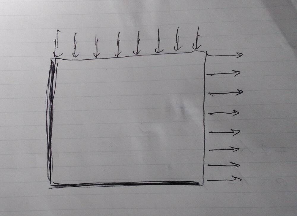

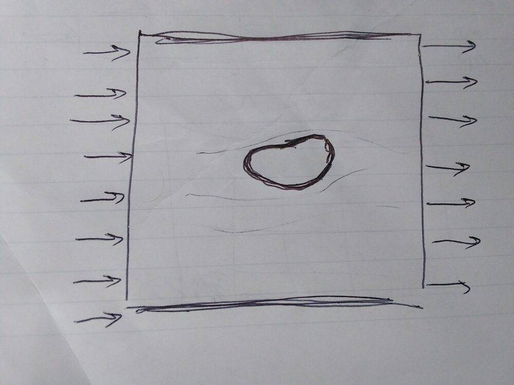

I think a good example would be flow around a bend. The left and bottom sides are walls (##\psi=c##), there's uniform flow inward on the top (##\psi## increases linearly moving to the right), and uniform flow outward on the right (##\psi## increases linearly moving up). My only concern is that the flow is discontinuous at the top right corner; would this be an issue?

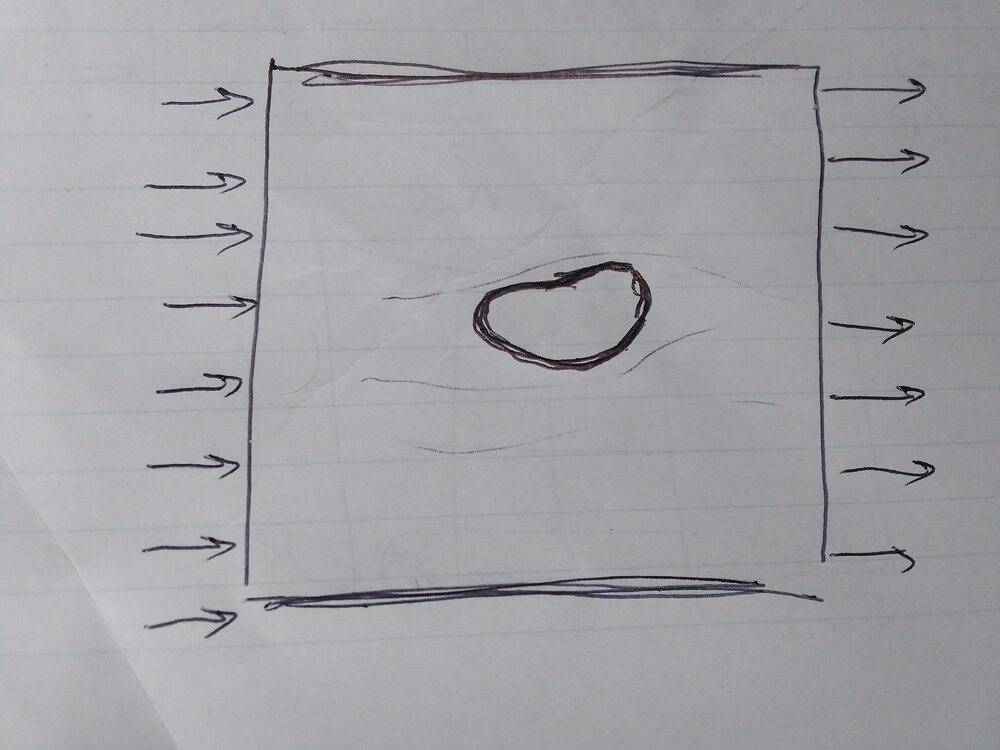

I also would be interested in modelling horizontal flow around an object. I assume ##\psi## around the boundary of the object would be a constant, but I'm not sure how I would know what to set it equal to. I imagine there would be a solution to the Laplace equation regardless of the value, but I think it would also indicate a different flow.
No problem. Just make sure that the values match at the upper right corner.
No problem. The boundary condition is just that the tangential component of stream function is constant. You don't need to set the value there. The differential equation becomes $$\frac{\partial^2 \psi}{\partial n^2}=0$$I think what you could do is choose a value of psi on the body and then iterate on it until the sum of the squares of the deviations from this differential expression are minimized.[/QUOTE]
Likes person123
I modeled the flow around a corner. It seems to work!
I'm still a bit confused about the boundary conditions for an immersed object. Wouldn't the stated relation always be true if ##\psi## was a constant based on the Laplace equation, regardless of the value of ##\psi##? Therefore, the sum of the square of the deviations would always be 0.
Nice job.
Yes, it would be true based on Laplace's equation, but, at the boundary, you need to use a 1-sided approximation to the 2nd normal derivative, and you need to guarantee that it is satisfied at all points along the boundary for the boundary value of psi you have specified.
Try it both ways and see what happens.
1. Satisfying the 1 sided 2nd normal derivative equal to zero at all points along the boundary, and including the boundary points in the solution vector. Then checking to see whether psi comes out to a constant for the boundary points.
2. Not including the boundary points in the solution vector and, instead setting them equal to a constant value and iterating on the constant value until the sum of squares of the 1 sided 2nd normal derivatives is minimized with respect to the chosen boundary value.
Likes person123
I'm a bit stuck for either approach. For the first, ##\frac{\partial^2 \psi}{\partial n^2}=0## implies that ##\frac{\partial^2 \psi}{\partial t^2}=0## but not ##\frac{\partial \psi}{\partial t}=0##. This boundary condition seems to be satisfied by flows which would not be the flow around an object, like uniform horizontal flow. Isn't the boundary condition I need ##\frac{\partial \psi}{\partial t}=0##? I'm not sure how I would solve the system of equations with that constraint though.
For the second approach, would I just be setting the values of the stream function at the boundary equal to some constant after solving for the function? That doesn't make sense to me, because I would imagine the object would change the stream function away from the boundary as well.
I think there's something which I'm just not quite getting with this.
If ##\frac{\partial \psi}{\partial t}=0## at all point along the boundary, then ##\frac{\partial^2 \psi}{\partial t^2}=0##.
Your numerical scheme will take care of that automatically, because the first grid point out from the boundary will be affected by the value you impose at the boundary.
