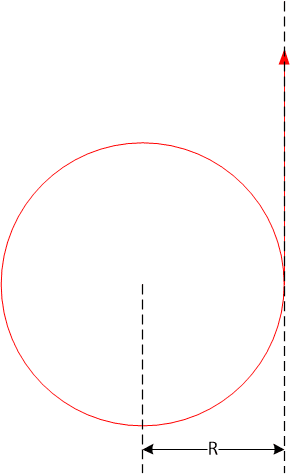

It is going outward only in the sense that the total distance to the axis of rotation increases. The perpendicular distance stays the same (figure 3 in the link, but I suspect there will be nice movies to be found as well with a little googling).

Perpendicular distance is the distance from the axis of rotation to the straight line of the trajectory the box follows after the string is broken: the tangent to the circle it was describing before. Top view:
R stays the same, even when the box flies further away from the axis of rotation in the direction it had at the moment the line snapped
