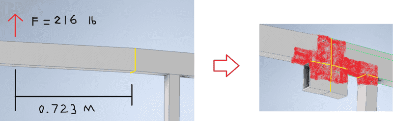

Hello All, I'm trying to figure out how to strengthen a box beam that's been welded to another box beam. In the photo on the left is 2 beams welded to each other, they are 2x1" Aluminum 6061-T6, with a 1/8" wall thickness. The yellow lines indicate the location of the weld. A force of 216 lbs is applied .723 meters away from the beam.
When aluminum 6061 T6 is welded, 5556 filler material can be used. The "Heat affected zone", or the area roughly 1 inch around a weld on aluminum will have greatly reduced mechanical properties, using filler material 5356, the yield strength of the HAZ is 15 ksi, compared to a yield strength of 35 ksi away from the HAZ. The filler metal has a yield strength close to >20ksi, so well focus on the weakest part of the weld- the HAZ.
If the maximum stress is calculated using sigma = My/Ixx
where M = 652.861 N-m, (it would be 694.995 N-m, but there is another force going downward that I forgot to include in the photo)
y = .0254 m (1")
Ixx = 1.380663 x 10^-7
Thus, the max stress is approximately 120 Mpa, which is greater than our HAZ yield strength of 15 ksi, or 103.42 MPa. So I need to beef up the area of the Heat affected zone. In the picture to the right of the arrow, you can see that I have proposed welding another 2x1 piece of aluminum 6061, thereby increasing the effective height of the beam in the area and increasing the local strength of the HAZ to well beyond the maximum stress.
But there's a problem, by welding more aluminum under it, we get new HAZs as indicated by the red splotches, on the bottom of our top spar we have a HAZ with only 15 ksi yield strength, but it transitions back to regular 6061 with 35 ksi yield strength just 1" up. My question is, how can I calculate or be sure that this new section- half HAZ, half normal, will hold up to the approximate moment of 652.861 N-m as calculate earlier?
Lnewqban said:
Could you change the section to be welded from perpendicular to angled?
Could you weld plates onto top and bottom of beam?
Please, see:
https://en.wikipedia.org/wiki/Scarf_joint
I cannot change the section to be angled, as the two pieces are already at a 10 deg angle to each other, if I tried to do the scarf or interlocking method it wouldn't work due to the 10 deg bend, I think..
I could weld plates to the top and bottom, but I think this would just lead to the same issue of having that half HAZ, half normal section..
Some ideas:
1) Make the top and bottom plates long enough that the stress in the HAZ will be low enough to be safe. Remember that the bending moment decreases as you get farther from the column.
2) Larger rectangular tube. If you have room to weld a 1 X 2 to a 1 X 2 tube, then there should be room for at least a 1 X 3 rectangular tube.
3) Make the added piece of 1 X 2 longer. Weld it directly to the vertical post, and make it long enough that the stress in the HAZ will be in the safe range.
4) Don't forget the safety factor.

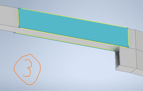

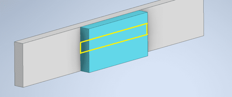

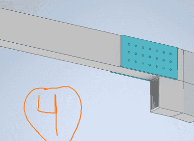

I've modeled some solutions to the problem, using ideas you suggested above, but instead of putting plates on the bottom, I think if I put them on the side it would work, maybe putting one on the bottom to resist cracking could work.
Solution 1: In photo 3 is two plates of 2x12”, 1/8” thick Al 6061 welded to the front and back of the top spar, by doing more welding along these plates, we will get more HAZs, but the idea is to push back (to the left of the beam) the un-reinforced section such that the lever arm is small enough that it can take the load. How much can I expect this method to increase the strength by?
Solution 2: In photo 4 is two plates riveted to the top spar, they are the same as solution 1’s plates, except they’re not as long since now we need only compensate for the original weld’s HAZ. How much can I expect this method to increase the strength by? I’m particularly worried about cracking at the bottom of the top spar, just below the riveted plate, would the riveted plate prevent cracking?

You figure this for yourself by calculating the moment of inertia for various modifications of the box beam. Use search terms calculate moment inertia rectangular tube to find how to do that.
For the riveted plate I think I can find some material, but the welded plate I'm not so sure is so simple. Because it's not a rectangular tube anymore, there two weld points on each side and those are the only thing keeping the welded plate attached, the thickness of the added plate can't just be added to the overall thickness of the side walls, I think, I'm not sure, I've already done a search online and can't find much to shed light on it.
If you add a plate, and weld it all around the perimeter, then it becomes part of the beam. You can weld plates to the sides, the top or bottom, or the top and bottom. The section I value is calculated as if the beam in the area of the plate is one solid part. If a plate is added to only the top or bottom, the I value and stress calculations are slightly more complicated. Do not add a side plate to only one side, the sides need to be balanced.
Riveted and bolted joints are more complicated to analyze. Since you have a highly stressed part, you should not use riveted or bolted reinforcements.

Actually wait! I have one more question. What if you didn't weld directly around the perimeter, but instead welded a perimeter smaller than the total height and width of the second plate like in this photo? You wouldn't be able to then consider it as one piece then right?
