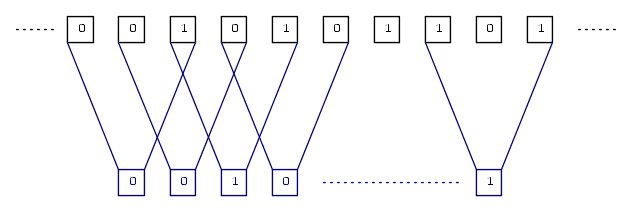

I have a system that consists of a huge number of boxes, it is not important to know how many, each containing a binary number:
In every cell, the probability that there is a '1' is p, so the probability that there is a '0' is equal to (1-p).

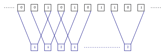

What I do is take them in groups of N and add them up. For each of these sums, I calculate the probability that it is at least M.
So:
if I do not make errors in the reasoning, the probability p' that the generic blue box contains a number greater than M is:
## p' = \sum_{j=M}^N \binom{N}{M}p^j (1-p)^{N-j} ##
In each of the blue boxes, I insert a '1' if the threshold M has been exceeded (or equaled), otherwise '0'. For example, in the previous drawing (where N = 3) if I use M = 2:

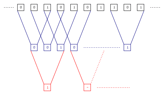

At this point I take another step, and this is where my doubts come from.
I again cover the blue boxes in groups of N, separately though:
I want to calculate the probability p' that is the probability that in the generic red box there is a number greater than or equal to 1. Surely I can write it like this:
where obviously (1-p'') is the probability that in the generic red box there is a '0'. This is the probability that in N consecutive blue boxes there is always '0'. In my opinion, I cannot simply say that
because it does not seem to me that the events are independent.
