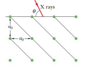

In picture, first-order reflection from the reflection planes shown occurs when an x-ray beam of wavelength ##0.260 nm## makes an angle ##\theta=63.8°## with the top face of the crystal. What is the unit cell size ##a_0##?
Bragg law
$$d=\frac{ n \lambda} {2 \sin \Theta}$$
I thought I must consider an angle ##\alpha =\theta -45°=18.8°## in bragg law and then $$a_0=\sqrt{2} \frac{ \lambda} {2 \sin \alpha}$$

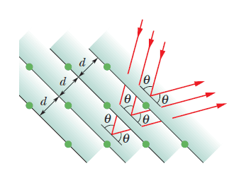

That's because I was sure that the angle of diffraction ##\theta## in bragg's law must always be measured with respect to the plane as in the following picture

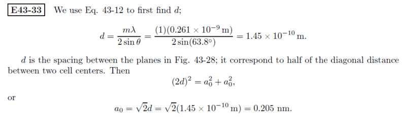

Nevertheless I cheked on solution manual found online here : http://omega.altervista.org/extra/key%20to%20Physics.pdf
And I found the following solution:
So the angle used in Bragg law is still ##\theta =63.8°## ! How can it be correct?

I think you got it right and the book's solution is incorrect, but I would need to double-check my result to be sure.
