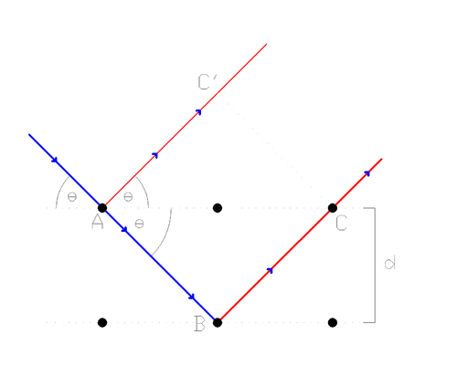

alright i pretty much understand everything now thanks heaps. what I am having problems with now is, well first of all you mentioned that "θ is the bragg scattering angle" but i thought [tex]\theta[/tex] was as shown in the following:
and so the scattering angle ie as stated in the question is "the angle, in degrees, between the incoming incident beam and the reflected beam" which by looking at that image we can see that this angle would be equal to 180 - 2[tex]\theta[/tex] in degrees right?
next thing is, i can get two angles for [tex]\theta[/tex] using this relationship nλ/2d < 1. one angle at 21 degrees and the other at 46 degrees. what [tex]\theta[/tex] am i supposed to use then to answer the question :confused:?? i read through the lecture notes some more and i came across something to do with "order overlapping" or something? not sure how to continue if I've potentially got two answers to the question haha
I'm pretty sure the Bragg scattering angle θ is normally defined as the angle between the 'lattice plane' and the incoming ray. So in your diagram the lattice plane would be the horizontal. The whole point of Bragg diffraction is that at certain values of θ or 2θ or 180 - 2θ or whatever (thats not particularly important -> except for exams!) let's call it 'some angle', you'll get your electrons/x-rays/neutrons constructively interfering, and this will appear as bright spots on a screen.
You can end up with more than one bright spot, at more than one angle! So both answers are right, one is the n = 1 diffraction, the second n = 2. Think about what would happen if you use higher energy electrons? Higher energy -> smaller wavelength -> more values of nλ/2d < 1 for different n -> more bright spots on your screen.

ahhh ok I am pretty sure i get what you mean. sorry to keep on asking questions, but from looking at that diagram and the ones in my lecture notes i can't see how θ is going to change at all. i mean every beam looks pretty parallel and there's only perpendicular intersections etc etc so for example looking at that diagram, if i find θ for n=1 to be 21 degrees then that's going to be referring to all the θ's in the diagram. so then if i find for n=2 for θ that its 46 degrees, where on the diagram would i be looking? I am trying to visualise what's goin on here. i get how the dots are being made, from each beam intersecting with each other causing the bright spot and since everything is at right angles and parallel that's why all the dots are arranged so nicely. but yeah where abouts am i looking when θ changes?
