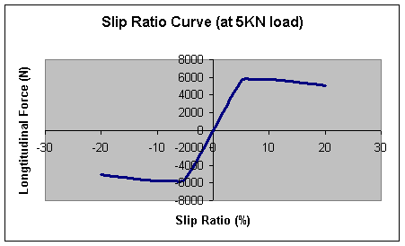

One has to arrive at a relationship between slip ratio and braking torque.This is how we were taught in class:

I have not yet arrived at the relation between brake torque F_B and the slip ratio.I go about this in 2 steps.
1.Arrive at a relationship between friction coefficient and slip ratio:
[Note:
Wheel starts slipping when slip-ratio s=1.]
2.Arrive at a relationship between braking force[itex]F_B= \mu F_{normal}[/itex]and slip ratio.
You can see that by the time the slip-ratio reaches -100%, you are left with almost negligible traction force being transferred to the road.This means,the wheel has started slipping at -100%.
You say in your question that you want the acceleration to be the same in both cases.So,now make use of this equation to calculate the normal force at the rear tire.
