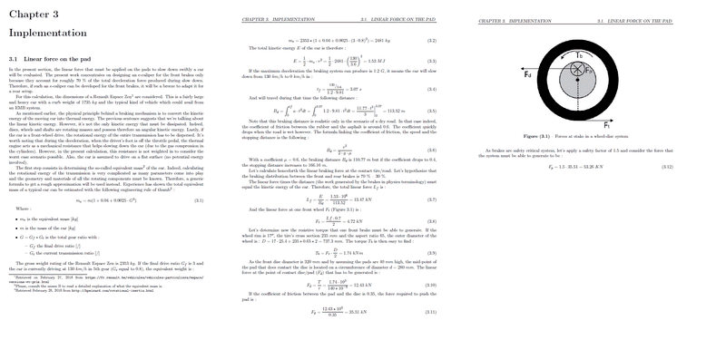

Hello,
I'm currently working on the design of an e-caliper and I need to this effect to determine the linear force at which the pads have to be pressed against the disc to slow down a car swiftly.
The result of my calculations is that the pad of a single front brake has to be pushed with a linear force of 35.51 kN (!) in order to bring to a halt (deceleration force of 1.2 G) a relatively weighty car (gross weight of 2353 kg) driving on the freeway at 130 km/h.
Is that a realistic value or is there something I've done completely wrong in my calculations ? It seems to be very high considering it's for a single braking unit.
I'd appreciate if you can take a gander at the attached picture and tell me if my calculations are right. (my apologies for the English typos in the text, it's just a draft and needs to be refined anyway).
Thanks in advance.
Guillaume.

I'm sorry for the picture, I didn't notice it was so blurry. I've converted it to a pdf file, it's a lot clearer.
Ok, so yes, your number seems to be pretty close to what I get.

  • braking_force_calculations.pdf

Although I agree with the magnitude of the value for the linear pad force, I don't agree with the way it is found in the attached document.
You only need 3 relationships to determine the linear pad force (based on figure 3.1 of the document):
$$F_t = \mu_t N$$
$$F_d r = F_t R$$
$$F_d = 2 \mu_p F_p$$
Where:
  • ##N## is the normal force acting on the wheel (i.e. the weight);
  • ##r## is the disc radius;
  • ##R## is the tire radius;
  • ##\mu_t## is the tire friction coefficient;
  • ##\mu_p## is the pad friction coefficient.
Note the factor of ##2## in the 3rd equation. That is because there are 2 pads acting on the disc, one on each side (that is important), even though they depends on the same linear force.
Note also that the maximum force that can be produced by a tire is determined by tire coefficient of friction and the weight of that tire. A braking system should be able to handle that maximum tire force (i.e. the tire should be the weakest point).
It doesn't matter how fast the car is going or how much inertia it has: The limiting factor is the tire friction force in all cases. The amount of energy the car has (i.e. speed and inertia) will only influence the heat absorption/dissipation of your brake design (which is mostly independent of the braking force).
Also, the deceleration is solely dependent on the tire friction force. So to get a high deceleration, you necessarily need a high friction coefficient. If we set ##F_t = ma## and ##N = mg##, it can be shown that ##\mu_t = \frac{a}{g}##, which basically means that to get a 1.2 G deceleration, you need a 1.2 tire friction coefficient. That is independent of the weight or speed of the vehicle.
Therefore, based on the 3 equations, the linear pad force is:
$$F_p = \frac{N}{2}\frac{\mu_t}{\mu_p}\frac{R}{r}$$
Assuming typical values:
  • ##\mu_p##: 0.35-0.42 ##\approx## 0.38;
  • ##\mu_t##: 0.9-1.0 ##\approx## 0.95 (typical passenger tires);
  • ##\frac{R}{r} \approx## 2.75;
  • ##N##: about 35% of the total weight (##W##) for one front wheel during braking (but it could be different with some vehicle designs).
Thus:
$$F_p = \frac{0.35W}{2}\frac{0.95}{0.38}2.75$$
$$F_p = 1.2W$$
And for a 2353 kg car, you need a 27.7 kN linear pad force on the front caliper.
Hi,
Yes indeed my previous calculations were erroneous. I wanted to edit my previous post to append the correct calculations but apparently it's the forum policy to prevent anyone to edit a message after 24 hours, so I left it that way.

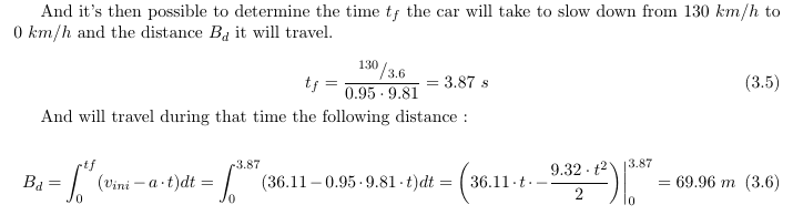

Actually, I got a decent order of magnitude by pure luck. Indeed, the integral to determine the braking distance traveled was completely wrong (don't know what I did there :/ ). Here is the correct equation :
I didn't think further as I thought the value made sense because I had read a bunch of articles referring to a stopping distance of around 110 meters at 130 km/h on a dry asphalt road but those distances always account for the driver's reaction time. Note to myself : always double check your calculations.
As the braking distance calculated was twice as much as the correct one (remember I was using a deceleration of 1.2 G instead of 0.95 G), it compensated for not dividing by a factor 2 when calculating the squeezing force required.
Anyway, thanks all for your help, I finally got it right.
