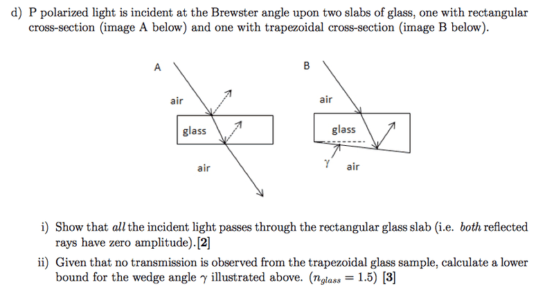

Hi all
I'm having difficulty on this part of a question Now, showing that all light passes through is to say that there be no reflection. This occurs when the angle of incidence on each of the two interfaces is at the required Brewster angle. As in the question, there will be no reflection at the first interface by definition since the beam is incident at the Brewster angle. For there to be no reflection at the second interface, it must be incident at ## θ = arctan(\frac{n_{air}}{n_{glass}}) ##. However, how can I prove that this is the case? Snell's law shall of course come into play.
Many thanks
Anyone? :)
For part a start by writing the Snell's law for the first interface, from there you have
n_a\sin\theta_1 = n_g\sin\theta_2
with ##\theta_1 = \arctan (n_g/n_a)##. Your next step would be to express ##\tan\theta_2## in terms of ##n_a## and ##n_g## only.

Ok here I'm using a hunch that ##\theta_1+\theta_2=\frac{\pi}{2}## . Doing so, and applying snells law at the bottom interface gives:
n_g\sin\theta_2 = n_a\sin\theta_1
But ##\theta_1=-\theta_2+\frac{\pi}{2}##
Substituting this into the equation by Snells law gives:
n_g\sin\theta_2 = n_a\cos\theta_2
This yields:
\tan\theta_2 = \frac{n_a}{n_g}
Which gives the appropriate Brewster's angle at the second interface. However, I'm not certain at to why my hunch should be true.

As for the second part of the question, by geometry we have that the angle of incidence at the second interface is ## x = \theta_2 - \gamma ##, where ## \theta_2 = arctan(\frac{n_a}{n_g}) ## from the previous part. Now essentially we're looking for a ##\gamma## such that ##x## is maximised. However, I'm unsure as to the condition for when there is only reflection and no transmission.
Check again your calculation, it should be ## x = \theta_2 + \gamma ##.
This is the case of the total internal reflection (TIR) which can only take place if the refractive index of the second medium is bigger than that of the first medium. TIR happens when
\sin x = \frac{n_a}{n_g}
From here you can find ##\gamma##. By the way, note that by comparing the above form of ##\sin x## and ##\tan\theta_2 = n_a/n_g##, you should see that ##x > \theta_2## asserting that the sign in front of ##\gamma## in the equation in the first line in this post should be plus.

Ah yes, total internal reflection. Thank you. Also, this seems trivial but I'm now having trouble obtaining the angle ##x##. I've attached my working.
You calculation is correct, but it depends on which incident angle you want to use in your analysis. I prefer to use the angle between the incoming ray and the normal line of the interface. If I define this angle to be ##x##, then ##x=\gamma+\theta_2##. Your ##x## in that calculation is the complementary angle of my ##x##.
