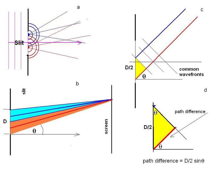

Also see my figure. Every point of the wavefront of light falling on the screen is source of new waves according to Huyghens' Principle (Fig.a). The rays reaching a certain point of the screen make the average angle θ with the original direction of light. To every point on the slit emitting rays in the blue region, there is a point in the red region D/2 distance apart, so that the path difference is the same Δs between them (Fig. b). The screen is far away, so the rays arriving to a point from different places of the slit may be considered parallel (same θ)
Fig c, shows two rays traveling at angle θ, originating from the red and blue points, D/2 distance apart. The path difference between the rays is shown. It is D/2 sinθ . If it is equal to half the wavelength, λ/2 or odd number of λ/2, the waves interfere destructively, and you see a dark spot on the screen.
You have two equations in the problem. sin35°= 4 (λ/D), and 1=m (λ/D) . (λ/D) is just a number. Can you calculate it from the first equation and plug into the second one to get the unknown, m?

Ok so the unknown m when the angle is 90 comes to 6.97, or roughly 7? and then that formula is for minima with a maxima on each side and if there are 7 minima then there are 8 maxima, right? and a total of 16?
The question was: "How many bright bands are on each side of the central maximum?"
The central maximum does not count. There is a maximum between the first and second minima, and then between the second and third minima up to the sevenths minimum: There is nothing after the seventh minimum, as it corresponds to 90° angle - a light ray going totally sideways, not reaching the screen.
ehild
ahhh that makes sense, the minima occurs last because after that, there can be no maxima because the surface the slits are in would be in the way. There are 7 minima starting on each side of the central maxima which means there is one less maxima than there are minima for a total of 6 maxima on each side of the central maxima, right?
Now, it is right.:smile:
