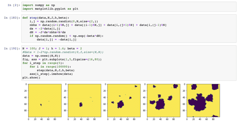

Just to show some pictures, you can imagine the ising model for example - spins taking values in $\{+1,-1\}$, with a small ('longitudinal', I suppose) field biasing it so that $\{-1\}$ is the true vacuum. Explicitly, the hamiltonian looks something like:
$$H = -J\sum_{\langle i,j \rangle} \sigma_i \sigma_j + h\sum_i \sigma_i$$
where $\langle i,j \rangle$ is a sum over the neighboring pairs of spins. Then, the configuration of all $+1$ spins is still a local minimizer for $H$, but local fluctuations to $-1$ spin will grow and look like bubbles, for example showed in this plot

I think i understand now, thanks to you guys. The bubble in the quantum field theory case has a surface tension that is due to the domain wall (analog to surface tension of a 2-phase interface) while its volume is energy favored. A bubble above a certain critical value will be energetically favored and expand. Quantum mechanical tunnelling probability is the analog of statistical fluctuations which produce bubbles of various size, but only the one with large enough size will expand.
