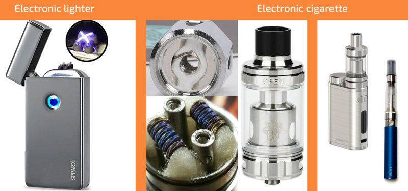

And what does "repurposing an e-cig lighter" mean?
No idea what you mean by "e-cig lighter." I never mentioned "e-cig lighter" in my inquiry, if you bother to re-read my previous post.
Seems like you're confusing electronic lighter with electronic cigarette. Electronic lighter is purpose-designed/built to light up traditional cigarettes, the ones with tobacco wrapped with paper, whereas electronic cigarette is purpose-designed/built to heat up cotton soaked with thick liquid to vaporize the liquid. The vaporized liquid may or may not contain nicotine depending on user's customization.
My more fundamental question, aside from technical questions in my previous post, is how do buck-boost converters inside electronic cigarettes handle such insane levels of current discharge despite being built with no so beefy components while being incredibly tiny in physical size compared to buck-boost converter mentioned in my previous post ?

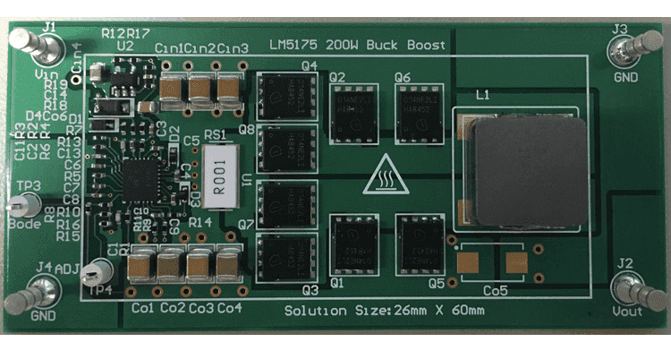

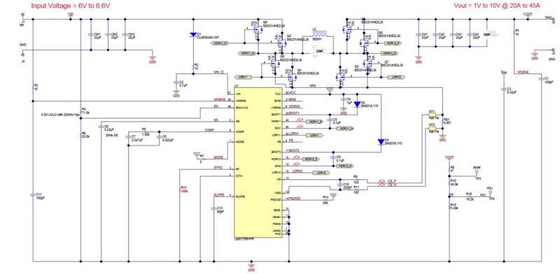

Texas Instruments has 200W 1V to 10V at 20A to 45A output synchronous 4-switch buck-boost converter design based on the LM5175 controller for e-cigarette applications. Schematic PDF here and test results PDF here. Overview here.Texas Instruments 200 Watts 1V to 10V at 20A to 45A output chipset board PMP20327

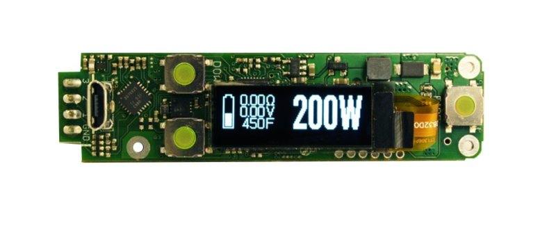

Evolv DNA 200 Watts 0.5V - 9V (up to 50A) output chipset board. Evolv DNA 200W datasheet here.
Texas Instruments 200 Watts 1V to 10V at 20A to 45A schematic (screenshot from schematic PDF)

Texas Instruments has 200W 1V to 10V at 20A to 45A output synchronous 4-switch buck-boost converter design based on the LM5175 controller for e-cigarette applications. Schematic PDF here and test results PDF here. Overview PDF here.
Can you just use that?

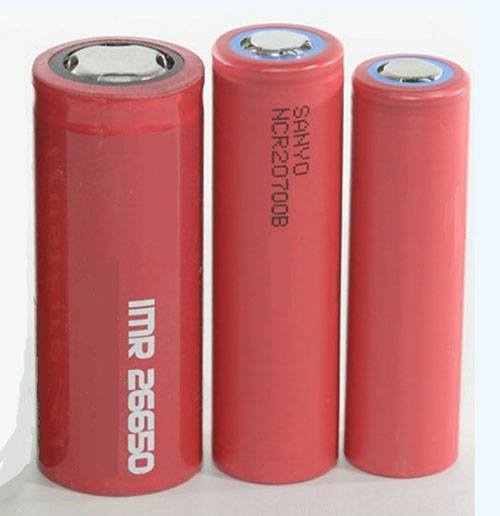

E-cig chipset makers are limited by what they can get out of 3.6V (nominal) lithium-ion and lithium polymer batteries.
18650 3.6V (nominal) lithium-ion high continuous discharge battery is the most commonly available and the widely used power source. Used in single or dual (series) or triple (series) and quad (parallel-series) connection.
20700 3.6V (nominal) lithium-ion high continuous discharge battery is far less available than 18650 3.6V and is far less used power source.
21700 3.6V (nominal) lithium-ion high continuous discharge battery is just as far less available and is far less used power source as 20700 lithium-ion battery.
26650 3.6V (nominal) lithium-ion battery is almost exclusively used as a single battery power source e-cigs.
Lithium polymer batteries are most commonly used for powering low power (about 70 Watts or less) e-cigs and is rarely used in high power e-cigs due to lithium polymer battery's inherent volatility at very high current discharge and due to other risk factors.

I highly doubt the schematic would be drastically different from other e-cig chipset makers however components used more than likely would be.
