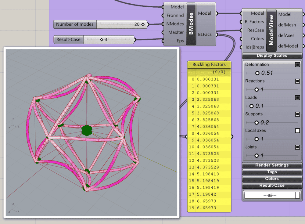

I'm trying to model the mechanical behavior (static, modal, and buckling analyses) of an underwater floating structure (e.g. submarine capsule or buoy) under hydrostatic pressure by Finite Element Analysis.
To obtain feasible results, the structure should be modeled as freely suspended, i.e. attached to nothing or with no-supports, am I right? However, most software available requires supports to perform calculations.
How should I perform FEA to get feasible results with a floating structure?
If I fix the 6 DoFs of one vertex, it is possible to obtain a feasible static analysis. Unfortunately, this unrealistic constraint severely affects both the buckling and the normal modes. The first three frequencies as well as the first three buckling factors are too low, as you can check in the two following images obtained in Karamba3D (parametric engineering software). In the images, the first 10 buckling factors and the differences between the 1st (unfeasible) and the 4th (feasible) buckling modes are shown for an icosahedral capsule:

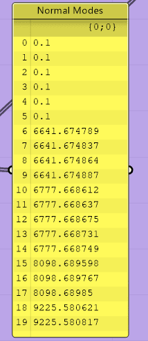

This is the first not-close-to-zero buckling mode using one central support with all DoFs fixed and 12 very soft springs (0.1 kN/m springs for 101 kN/m2 hidrostatic pressure). Buckling factors and Normal modes frequencies are also shown.
However, there is still something that worries me: Why there are just 3 close-to-zero modes for buckling analysis whereas there are 6 for normal mode analysis? The first 3 buckling modes seem to be rigid body rotations… but what about the 3 translations? Shouldn't be there as well?

Normal modes represent all the infinitesimal vibration shapes that a given system would experience without any forces, just as a consequence of its own stiffness and mass distribution. Thus, my “submarine capsule” system attached to the ground by weak springs has 6 close-to-zero vibrational modes since it should be able to almost-freely vibrate as a rigid body (3 translational + 3 rotational DoFs). So there is not problem at all here.
By contrast, the results provided by buckling analysis are different. Buckling modes represent the shapes and the critical load level that turn the system unstable. This means that above such loading level any infinitesimal displacement will not be counteracted by the corresponding reaction and the structure will fail. In other words, the reaction capacity of the system is exhausted.
For simplicity, let's consider a unidimensional (1D) case, for example, a doubly pinned column axially compressed. When compression force reaches the critical Euler buckling load, the capacity of the column to withstand infinitesimal lateral perturbations disappears (i.e. the external load action in the infinitesimally distorted column produces a greater torque than the reaction the column is able to produce) and thus buckles according to the well known “compressed spaghetti” shape.
If the support and its reaction force are replaced by an external load (equal but opposite to the load on top) and two dummy weak springs at both ends attached to fixed supports, the system becomes analogue to my floating capsule problem (practically “floating free”). In this case, the buckling mode shapes should be equivalent as for the doubly pinned case. I mean, there should not appear any translation buckling mode since this motion does not cause any instability. In other words, the reaction capacity of the dummy springs does not exhaust for any compressive load.
In the 3D case of my capsule, the 3 close-to-zero buckling modes observed are rigid body rotations because they correspond to the “rotational” buckling of the springs connecting the vertices to the central fixed node (at some loading point they do not oppose sufficiently to infinitesimal rotations). Similarly to the 1D case, there are no translation modes since any increase in compressive pressure does not reduce the capacity of the dummy springs to withstand any rigid body translation. Of course, all this reasoning depends on how springs are implemented in the FEA software.
