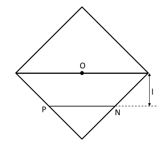

A square metal frame in the vertical plane is hinged at O at its centre as shown in the figure. A bug moves along the rod PN which is at a distance ##l## from the hinge, such that the whole frame is always stationary, even though the frame is free to rotate in the vertical plane about the hinge. Then, the motion of the bug is simple harmonic with the time period
A)##2\pi\sqrt{l/g}##
B)##2\pi\sqrt{2l/g}##
C)##2\pi\sqrt{4l/g}##
D)##2\pi\sqrt{l/(2g)}##
There are two forces acting on the frame, friction (f, along PN) and normal reaction due to bug (N', vertically downwards). Since the frame must not rotate, ##fl=N'(\sqrt{2}a-2l-x) \Rightarrow f=N'(\sqrt{2}a/l-2-x/l)##, where ##x## is the displacement of bug from P and ##a## is the side length of square frame.
The bug moves from P to N and the frictional force on bug is directed from N to P. Applying Newton's second law on bug, ##m\ddot{x}=-f=N'(x/l-2-\sqrt{2}a/l)##. This doesn't turn out to be SHM. :confused:
Any help is appreciated. Thanks!

It might be nicer to let ##x## be measured horizontally from the midpoint of PN.
What force acts on the bug to accelerate the bug? What does this tell you about the magnitude of ##f## acting on the rod? [Edit: Sorry. At second glance, it looks like you have already answered this.]
What can you say about the magnitude of the Normal force N'?

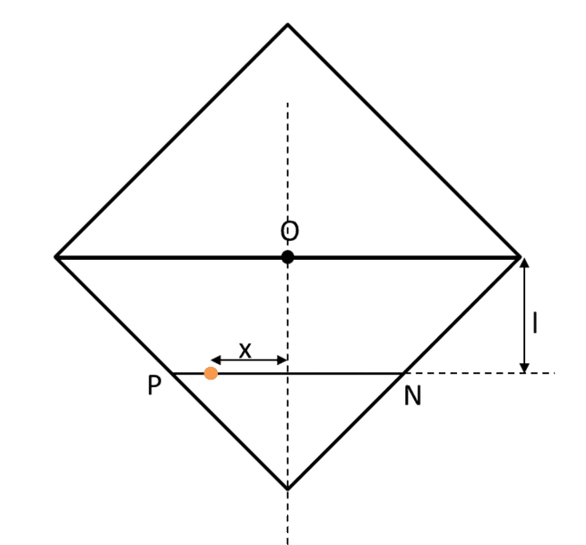

There's nothing wrong with your ##x##, you'll still get SHM. But I think you'll see why choosing the origin in the middle of the rod makes the expressions simpler.
You almost have it. What would need to be changed in your equation for ##\ddot{x}## to get SHM. Can you justify the needed change? (Hint: Does your symbol ##f## stand for the force that the bug exerts on the frame, or the force that the frame exerts on the bug?)

We must not be defining ##x## in the same way. I am thinking of an x-axis running along the rod PN with origin ##x=0## at the midpoint of the rod. Positive x is toward the right. As ##x## increases, the bug moves farther away from P.
Sorry for not understanding your definition of ##x##.

I am going with your definition of ##x##. Let the length of rod be ##k##. Then, the displacement of bug from P is given by ##s=k-x## and acceleration of bug is hence ##d^2s/dt^2##. Am I right so far?
Pranav-Arora said:
I am still confused with the signs. :(
If you are going with my definition of x, surely s must increase as x increases. Remember, I choose positive x direction to be toward the right. Your picture seems to be taking x positive to the left.
The algebra will be simpler if you consider displacement from the centre of the rod. If x is displacement to the right, the torque from normal force is mgx clockwise. The horizontal acceleration of the bug is ##\ddot x##, so the force on the rod from the bug is ##m\ddot x## to the left.
Ah, I think I get it now, I was being really foolish. :redface:
The displacement from P is ##s=k/2+x \Rightarrow d^2s/dt^2=d^2x/dt^2##. Hence,
$$F=m\ddot{s}=m\ddot{x}=-f$$
This turns out to be SHM, thanks a lot TSny! :smile:

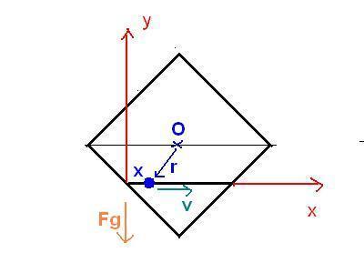

I meant the torque equation for the whole system bug+frame. Friction is an inner force between bug and frame, it does not count.
I choose a system of coordinates with horizontal x axis. pointing to the right and vertical y axis, pointing upward.
The only external force is gravity. Its torque with respect to the hinge is τ=-xmg The angular momentum of the whole system is that of the bug as the frame does not move: L=lmv
[itex]\tau=-xmg [/itex], [itex]L=Mlv[/itex], [itex]\tau= \dot L \rightarrow -xmg=l m \dot v \rightarrow -xmg=lm\ddot x [/itex] which corresponds to the equation of SHM.
When writing up torque and angular momentum with respect to the centre of the frame do not forget that they are cross products. L=rxmv, τ=rxF.

With the coordinate system shown in the picture, the hinge is at (b/2, l) (b is the length of the rod). So r=(x-b/2)i-l j. τ=rX(-mg j)=-mg(x-b/2)k, and L=rXmvi =lmvk. τ=dL/dt--> -(x-b/2)mg=lmd2x/dt2.
Going back to forces acting on the frame and bug separately: The bug exerts normal force on the rod, it is equal to mg (downward) and its torque is mg(b/2-x), anti-clockwise (b is the length of the rod).
The bug exerts some frictional force f on the rod, and the torque of that force compensates the torque of the gravitational force. f l+ mg(b/2-x)=0
The bug exerts f force on the rod, the rod exerts -f force on the bug. So the motion of the bug corresponds to ma=-f=mg/l (b/2-x)
If the bug starts from P (x=0) and its initial speed is 0, it will move according to x=bg/(2l)(1-coswt)

Thank you very much for the explanation, I think I see the error I had with the signs. The direction of forces was alright in my working (I think) but I messed up with the torques, thank you again. :)
