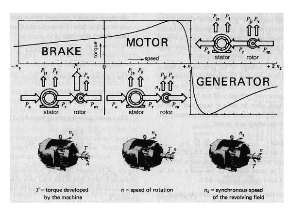

Induction generator has the nice feature it won't backfeed into a dead grid and electrocute a lineman, like a simple inverter can..
In your shoes i'd try to cultivate experts like Anorlunda by sharing more details of your experiment.
Like a dynamo, an ordinary induction motor will induction generate by simply overspeeding it slightly. Plus it has no brushes and is cheap. But that might need a gearbox.
