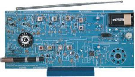

Here is a kit which seems to use simple parts. I can see one integrated circuit for the audio output, but otherwise it uses individual transistors.
http://www.mcmelectronics.com/product/ELENCO-AMFM108K-/80-1195
It costs about $37.
However, I really doubt that you would learn anything by building it and there is a chance you would not be able to get it working without test equipment. This is especially true if you make any errors in constructing it.
For comparison, I have a 1 GB MP3 player that would hold about 250 songs and it cost about $25. It has a superb sounding FM radio, with a digital frequency readout, built into it.
It would be a much more practical project to build an AM radio or even some test equipment. Perhaps an RF signal generator.
FM radio is on VHF and this means you need very careful construction techniques to get usable results.
