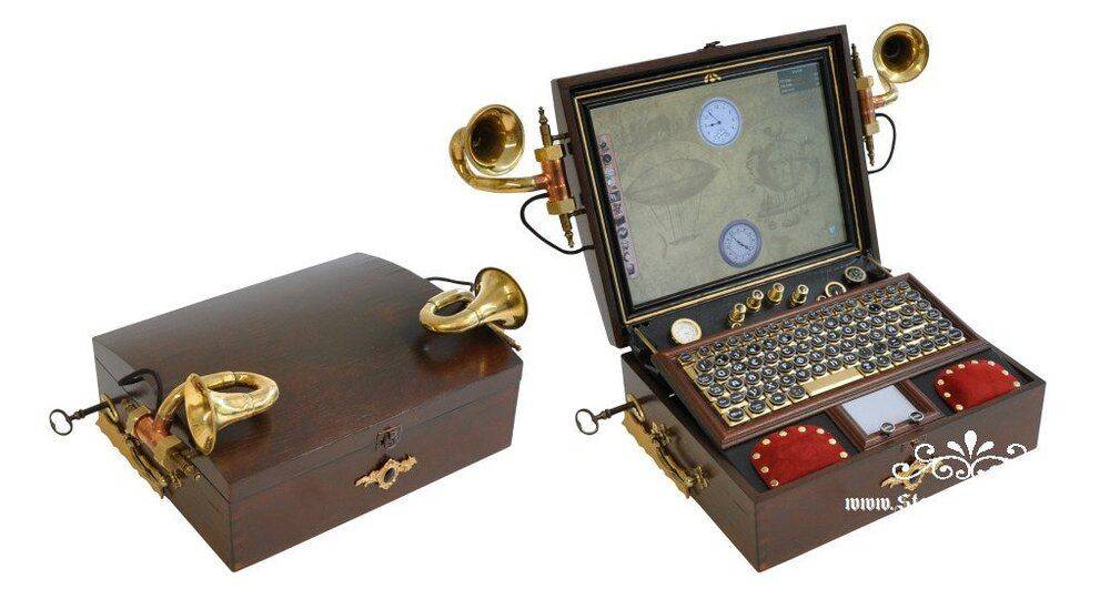

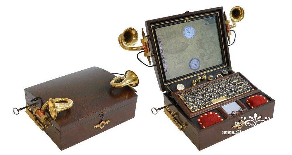

Well, the laptop with a dock is what I've done for the past 10 years. As I said, it's a little hard to spec one out just as I want (backlit numeric keyboard, 17" IPS monitor - but I might accept a 15", integrated graphics and i5 for lower power consumption/heat than a graphics card and i7, charge/video/audio through USB-C for one cable docking, RJ-45 conn for troubleshooting the network ) , and then I'm stuck with that config, and one bad component takes it all down, and may be difficult to repair.
Actually, the steam-punk approach is just what I'm thinking of, though I wouldn't get quite so artsy with it. Though I might have fun making a decent wooden case. The brass horn speakers are a nice touch though!
