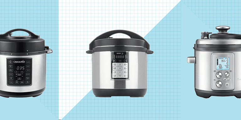

Sorry if this is a dumb question (or was mentioned earlier in the thread and I missed it), but would a traditional pressure cooker work? I don't know what PSIg ratings most pressure cookers have but that seems to be what pressure cookers are for, no?
My wife loves her InstaPot, which apparently is a combination of pressure cooker and other cooking features all in one appliance. Is there maybe an InstaPot recipe for doing this herb infusion already? :smile:
https://www.goodhousekeeping.com/ap...eviews/g204/electric-pressure-cooker-reviews/
https://www.target.com/p/instant-pot-duo-6qt-7-in-1-pressure-cooker/-/A-50608360?ref=tgt_adv_XS000000&AFID=google_pla_df&fndsrc=tgtao&CPNG=PLA_Appliances%2BShopping_Local&adgroup=SC_Appliances&LID=700000001170770pgs&network=g&device=c&location=9032181&ds_rl=1246978&ds_rl=1247068&ds_rl=1248099&gclid=CjwKCAjw7-P1BRA2EiwAXoPWAxSNUC9bPNLWorUiqFEVS-nDhs3ytUcWlKD765C7owa-ZNkhIOtP8BoCmRQQAvD_BwE&gclsrc=aw.ds
Likes russ_watters

I welcome all questions and info
There are 2 issues with the pressure cooker
1- they are small and I want to be able to do at minimum 10lbs per session
2- I do not want to cook the herbs I just want to infuse them with a complimentary flavor essence
Waaay back in my chilhood days, the stovetop pressure cooker had a weight the fit over a vent in the cover... it had three positions labelled "5", "10", "15" lbs.
A quick Google search found a statement that most are 15 lbs.
Here's a 21 quart pressure cooker:
https://www.plantbasedpros.com/prod...T6JqCFW0ci28gVxPN4RBwt1whPUepfAhoC25IQAvD_BwE
If it doesn't allow setting the pressure without heating, then you might also try a beer keg system. I use a 1.75 gallon system that pressurizes up to 30psi. 1.75 gal of mostly water is about 15 lb.
