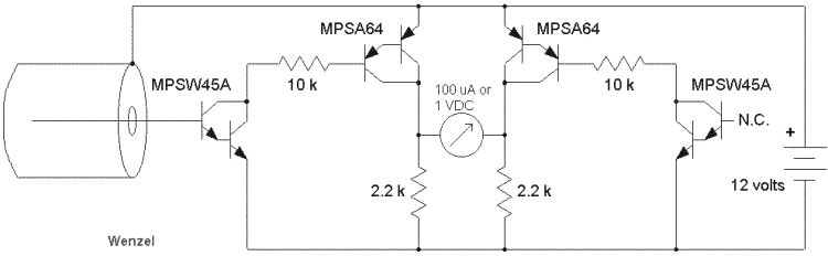

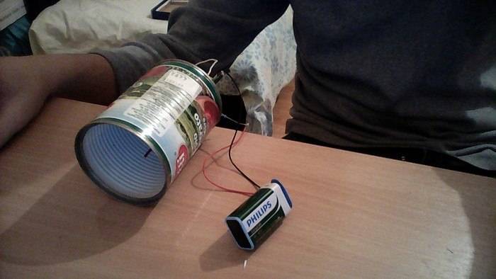

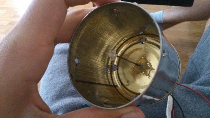

Hi guys I want to show you my first prototyp for my ion-chamber (first) thank you on your support and help!
I found a web page that has good documentation about building ion chambers there I found a schematic so I wanted you guys to check it first before I start ordering anything here is the picture:

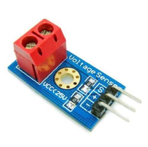

For the VDC I thought using a digital voltage sensor like this one:

I don't know how ambient pressure will effect your ion count, but that circuit will be very sensitive to temperature...
I don't perceive any means to trace your ion detector back to any measure of UV...

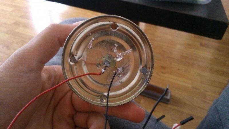

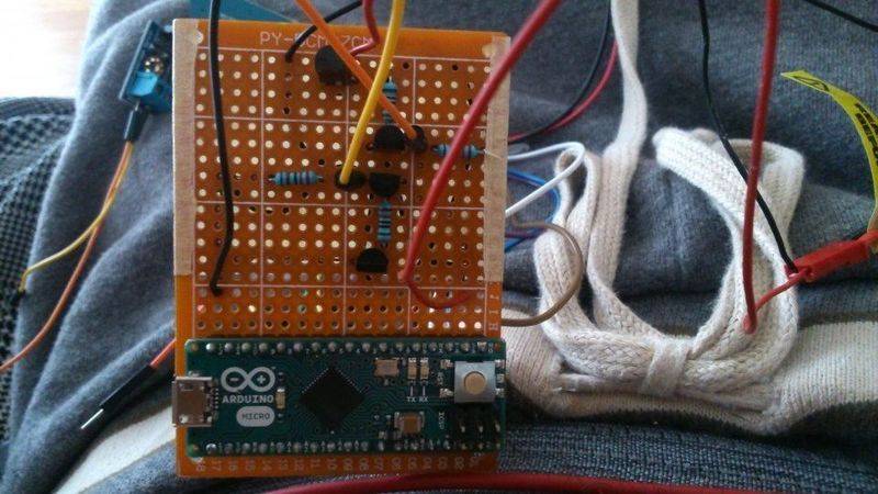

Hi all after some time of work I made this much:
So I put it all together like you can see in the pictures. When I just power up the ion-chamber the the voltmeter shows me the voltage of 4.5V and after a while it comes to 1.5V-3V and I'm confused about it. Should it not have a stable voltage?
Board:
Voltmeter and SD card adapter:
Ion chamber (from outside and inside):

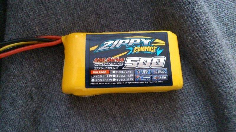

Battry to power all things:
An “electrometer” amplifier measures very low currents. There are techniques necessary to maintain high levels of insulation with very low leakage. For example, an electrometer is usually operated with the input lead bent away from the PCB. Where you use glue at the hole through the end of the can, the glue will attract moisture and short circuit the ion collection. Both ends of the can need to be removed. The central wire should be supported on a thin polycarbonate or polystyrene thread or cross member at each end. I would expect at least 100V DC on the centre electrode since it must accelerate the ions prior to collection on the wire.
It is a bit difficult to comment on your observations without an annotated circuit diagram. Please attach one to your next post.
