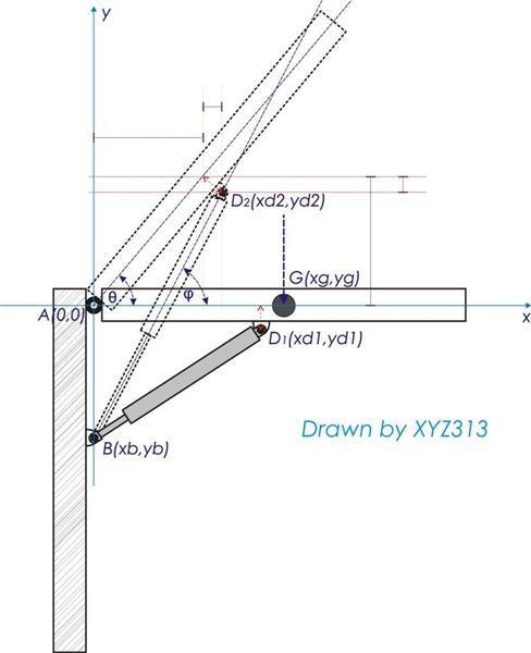

Thanks for your reply. I attached a picture of gas spring attached to the lid.
In correct installation the correct inputs would be (speaking of the drawing and on existing example):
Hinge coordinates - (0,0)
G=W - center mass - assume evenly distributed - 50lbs; coordinates (a1=25,0)
A(ax,ay) - coordinates of the point, spring attached to the lid; assume ay=0; ax=a2= 22;
B(bx,by) - coordinates of the point, spring attached to the base; assume bx=0; by = -15;
alpha=theta(max)=50deg
beta=phi(max)-gas spring slope angle +x
Assume L1 is gas spring's length when theta=0; fully compressed;
Assume L2 is gas spring's length when theta=theta(max)=50; fully extended;
L1=[(ax-bx)^2 + (ay-by)^2]^0.5= 27 (rounded)
L2={[a2*cos(theta) - bx]^2 + [a2*sin(theta) - by]^2}^0.5=[(22*0.6428)^2 + (22*0.7660+15)^2]^0.5 = 35 (rounded)
We are mainly interested at the weight applied at attached point of the lid when the gas spring fully extended, therefore at extended state, where alpha=theta(max)=50deg, let's calculate beta=phi(max):
beta = acos{[a2*cos(theta) - bx]/L2} = acos{[a2*cos(50deg)/L2} = 1.1530 (radians)=66 degrees
and according to your formula
P1 = -W*a1*cos(alpha)/[a2*sin(beta - alpha)]=-50*25*cos(50deg)/[22*sin(16deg)]=-133 (rounded);
yes it yields correct answer; :approve:

XYZ313: The sign on P1 is explained in post 7. Reread the explanation in post 7. Your negative sign on P1 is correct.
Your example is different from the previous example in this thread (e.g., you reversed the values for a1 and a2), but that is OK.
For your example, your answers are correct. Nice work. The correct answer in your example is actually P1 = -132 (rounded), but you got -133 probably because you rounded so much.
Notice, as stated in post 7, my solution in post 7 requires that points A and D in post 7 must lie on the lid midplane. (But you used all different nomenclature, except for point B, which makes the thread somewhat confusing.)

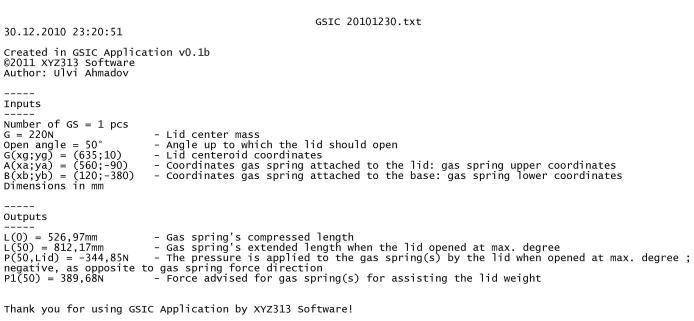

nvn: yes, I used different nomenclature, but therefore I posted that drawing. One more thing, assuming that point A (D in your post) is close enough to midplane, calculations still true. Moreover it is located at substantial distance from the midplane trigonometry could be of help :)))
And I reversed values a1 and a2 intentionally, as attaching gas springs to the lid at the point between hinge and center mass makes more sense, and corrected (bx=15,by=0) to (bx=0,by=-15) which makes more sense... In gas spring design works it is accepted to add 10-15% to P1 value to assist with weight... And yes, those are rough calculations...

I don't have a book in mind to refer you to. Unlike post 7, in the following solution, the hinge and gas spring upper end are no longer required to lie on the lid midplane. Below, I use the same nomenclature I used in post 7, except I changed the names bx and by to xb and yb.
Let the hinge axis of rotation, point A, be at the origin; therefore, the (x, y) coordinates of point A are A(0, 0). Let the base of the gas spring (the lower end pin) be point B, having coordinates B(xb, yb). The lid centroid is point C. The upper end of the gas spring is point D. Let us use the following nomenclature. The following solution assumes the hinge pins are virtually frictionless (well greased).
  • xb = x coordinate of gas spring base pin.
  • yb = y coordinate of gas spring base pin.
  • a1 = x coordinate of lid centroid when theta = 0.
  • a2 = x coordinate of gas spring upper end pin when theta = 0.
  • a3 = y coordinate of lid midplane when theta = 0.
  • a4 = perpendicular distance from lid midplane to gas spring upper end pin (point D); positive downward. Positive a4 means point D is below lid midplane; negative a4 means point D is above lid midplane.
  • theta = lid slope angle, measured from the +x (horizontal) axis.
  • phi = gas spring slope angle, measured from a horizontal axis.
  • W = lid weight (positive downward).
  • xd = x coordinate of point D.
  • yd = y coordinate of point D.
  • L1 = gas spring current length.
  • P1 = gas spring axial force, applied by lid to gas spring at point D due to gravity (with no human pushing up nor down on the lid). Positive P1 means gas spring in tension; negative P1 means gas spring in compression. If there are two gas springs, divide P1 by 2.
xd = a2*cos(theta) + (a4 - a3)*sin(theta).
yd = a2*sin(theta) - (a4 - a3)*cos(theta).
L1 = [(xd - xb)^2 + (yd - yb)^2]^0.5.
phi = acos[(xd - xb)/L1].
P1 = W*[a1*cos(theta) - a3*sin(theta)]/[yd*cos(phi) - xd*sin(phi)].
Now, subtract P1 from the spring force in the gas spring, to obtain the net gas spring axial force applied at point D.
Important: The above solution is valid only if yd - yb ≥ 0. The domain of the above solution is -90 ≤ theta ≤ 180 deg, 0 ≤ phi ≤ 180 deg, and yd - yb ≥ 0.
As an example, let's say a lid is 1270 mm long, the lid midplane is 10 mm above the hinge axis (when theta = 0), point D is 100 mm below the lid midplane (when theta = 0), and the x coordinate of point D when theta = 0 is 560 mm. Therefore, a1 = 635 mm, a2 = 560 mm, a3 = +10 mm, and a4 = +100 mm. Let's say xb = 120 mm, yb = -380 mm, W = 220 N, and theta = 50 deg. Therefore, xd = 428.905, yd = 371.134. Notice yd - yb = 751.13 mm ≥ 0, which is within the valid range. Therefore, using the remaining equations, above, gives L1 = 812.173 mm, phi = 67.645 deg, and P1 = 220*400.510/(-255.512) = -344.85 N.

is it possible for you to plot forces (vectors) involved?
Done,
nvn: Many thanks for your great help.
