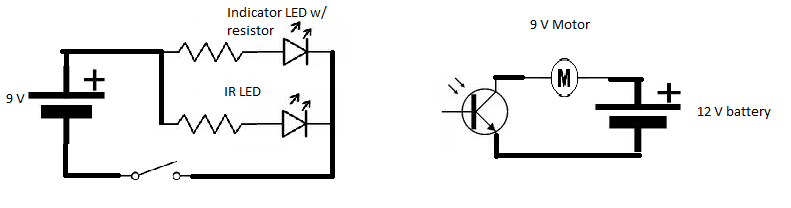

Hey. I am trying to build a circuit which would switch on/off another device. So far I have tried using an IR LED on the controller and with a phototransistor on the load device (which has it's own batteries), but I cannot figure out how to get it to work. I do not need complicated signals, just a simple on/off toggle to switch on a 9V motor in series with a 9V battery (like a regular manual switch).
Does anyone have any suggestions?
Thanks.
There are a couple reasons why this circuit may not be working, but here's a guess at a solution.
Assuming the IR LED and the phototransistor are working (basically that the LED is turning the transistor 'on' when lit and 'off' when not lit), the circuit you described is basically a push button instead of a switch. When you flash the LED, the transistor will be 'on' until the LED goes out. What you need to add to the circuit is a latch of some kind.
A latching relay would probably do what you need. Connect the emitter of the transistor to 9v, and connect the collector to the input of a latching relay. When the transistor switches 'on', this will latch the relay closed. Connect one side of the relay contact also to 9v, and connect the other end of the coil to your motor (or whatever you want.) Pulsing the IR LED will latch the relay open or closed, and will connect/disconnect power to your load.
Hope this helps.
Can you describe how your circuit is not working? Is it failing to turn on even at close range? Perhaps you could post your schematic.
Usually in these applications the IR is modulated to distinguish it from ambient light. The frequency you use can be almost anything except the power line frequency, its second harmonic and that used by CF bulbs which I believe is about 40 kHz. The receiver needs to filter out everything except your modulation frequency.
Thanks for the quick replies. The circuit is basically supposed to allow a remote to shine an infrared light to turn on or off a motor. The circuit I'm using right now (which isn't working) is:
While using in the above diagram, the voltage across the motor only rises to maybe .5V maximum; however if I use a single resistor as the load the voltage will almost completely transfer. I think this may have to do with the maximum current output of the photo transistor but how could I remedy this?
This problem is compounded by the fact that the phototransistor only seems to work from very close range, making the device impractical (what's the point of a switch if you have to touch it anyway...).

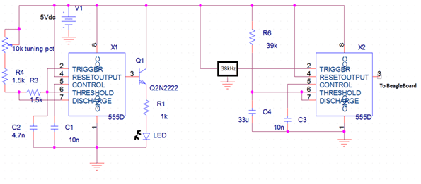

Modulate just means to change something, usually to add extra information to it.
This is a typical 38 KHz transmit / receiver setup.
http://dl.dropbox.com/u/4222062/38%20KHz%20oscillator-receiver.PNG
The infra red LED is switched on and off at a 38 KHz rate.
In normal use as a remote control, this 38 KHz switching is sent in bursts to send data to a TV, say, to change channels etc.
The wire going off to the right of the receiver is an output which would go to a circuit like this:
http://dl.dropbox.com/u/4222062/NPN%20%20driver.JPG
This can control enough current to drive a small relay which would switch a motor. There might be enough current to run a very small motor.

Anyway, maybe you could try this one:
http://dl.dropbox.com/u/4222062/38%20KHz.JPG
It should give 38 KHz when the 10 K pot is at about 4K and it should give about 16 KHz at the 10 K setting on the pot.
You would need to get a 0.0047 uF capacitor. Any type except ceramic would be OK.

The 1.5 nF capacitor is the one controlling frequency. You would make it bigger to lower the frequency.

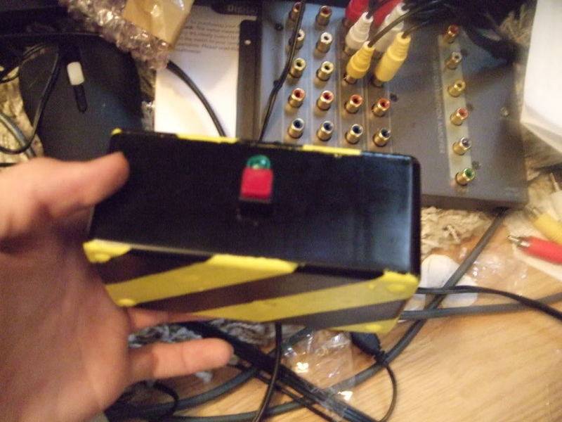

Before I post I just wanted to say that you guys rock. I've never gotten this much help from a forum before.
I got the 38 kHz receiver working on the breadboard and am about to solder it now. The relay I bought is a 5V SPDT micromini with a nominal coil current of 90 mA. I have not learned about transistors yet, but if I were to send the small current created by the receiver into the collector of an NPN transistor with 5V across it's base, wouldn't that amplify the current by 50 (assuming that is the Hfe)?

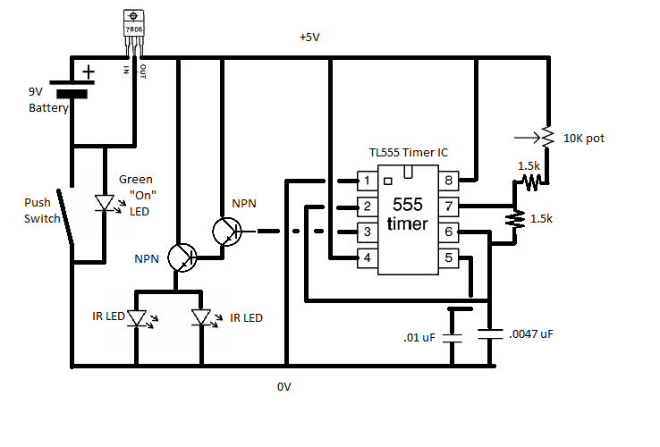

I am using a 5V regulator to power the transmitter from a 9V battery. The problem is that the IR diode I am using has a Vf of 1.2V and ideal current of about 80 mA. The voltage across my diode + current limiting resistor is now 1.4V (as opposed to ideally about 5V). So even though the frequency is consistently measured at 38kHz I can get no response from the IR reciever. Would there be some way for me to remedy this?
Thanks.
If you are measuring the output of the 555 with a multimeter on "volts", then it will tell you lies.
It will read the average voltage, but the output is pulses, so it will average the pulses to give a steady reading. This will be lower than the peak voltage of the square wave output.
Try bringing a TV remote control near the receiver. If it is working OK, it should react to that.
Be sure your receiver chip is wired up according it its data sheet. These connections may vary.

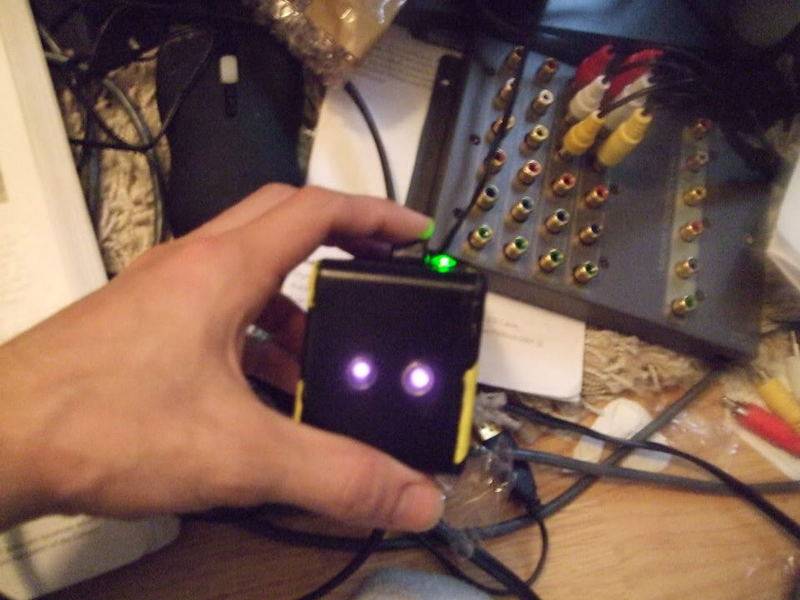

One good trick is to look at the transmit diode with the viewer of a digital camera or camcorder. These can detect the infra red light and give you a clue about whether the LED is working or not.
Man. I am using the DMM to test the current output of the IR reciever. I can't seem to see ANY change from shining 38 kHz of IR at it, which the DMM tells me has a DC voltage of .9V (so 1.8-ish volts).

Hm. I don't think the diode is getting the required voltage to turn on. I can't see anything on my digital camera (unless you need a special setting?). Before I unsolder the 5V regulator to apply a higher voltage, I was wondering if that would work. The IR diode has a forward voltage of 1.28 with 100 mA.

I can see the IR transmitter with my digital camera, I just had to put it on night mode.
It's strange, but I can't seem to get ANY change in signal out of my 38kHz IR receiver; even using the exact circuit you drew (with my transmitter and with a remote).
I also don't really understand why the resistor is connected between the input and output (wouldn't that cause current to flow even with the IR receiver is not receiving?).

Is there any way to increase the voltage of the output pulses? Compared with another remote side by side it is only about half as bright (using digital camera).
I managed to use the remote to light an LED using this circuit:
[PLAIN]http://www.reconnsworld.com/ir_ultrasonic/40khzirtest.gif[\IMG][/URL]
I tried connecting the base of an NPN transistor where the LED is, with the emitter where the LED connects to the IR receiver. I then connected a motor with the top connected to a 9V battery to the collector of the NPN. My hope was that a small current into the base would allow current to flow through the motor.
Any help is appreciated.
Thanks.

You can increase the LED current by increasing the voltage on the TLC555 or by reducing the size of the resistor in series with the LED.
The voltage can be up to 15 volts but the output current should not be more than 10 mA, according to the data sheet.
So, you would need to use a transistor to drive the transmit LED, like this:
http://dl.dropbox.com/u/4222062/LED%20driver%202.jpg
That 20 K resistor can be made lower if you want more LED current.
I modified your diagram to give a couple of drive circuits for your 38 KHz receiver.
Glad you got that working.
Both circuits turn on the relay when a signal is received.
Depending on your motor and what types of relay you can get, the first circuit may be adequate or you may need to use the second circuit.
I favour using a relay to drive the motor. Motors can draw a lot of current if they stall and this might damage the drive transistor.
http://dl.dropbox.com/u/4222062/38%20KHz%20receive.PNG

Would this design work to increase the output from an LED? The one above doesn't seem to amplify it to it's maximum light output (as compared side by side to the same diode with 60 mA of current through it).
Do you think this would amplify the current up to high brightness?
Feeding the output pulse into the body of an NPN transistor, with the collector connected to +5V, with the emitter connected to the body of another NPN transistor (with it's collector connected to +5V) with it's emitter connected to the IR diode then connected to ground.
edit (Possibly the transistor I am using could be wrong? Switching NPN transistors, bought in bulk from radioshack).
  • #34
The first circuit (with the PNP transistor) doesn't make sense to me. The base is connected to the output of the 38 kHz receiver. This output (when it receives 38 kHz IR light) is 0 V. This would case the base and the emitter to be effectively grounded, and the transistor could not send any current (the pn junction would be at 0V -> no current flow).
Am I thinking of this wrong?
Thanks again,
John
  • #35
Yes.
The emitter of the PNP transistor is at +6 volts. For the PNP transistor to turn on, it has to have less than + 5.4 volts on the base.
This happens when the output of the receive chip goes to zero volts.This circuit works better for the transmitter:
