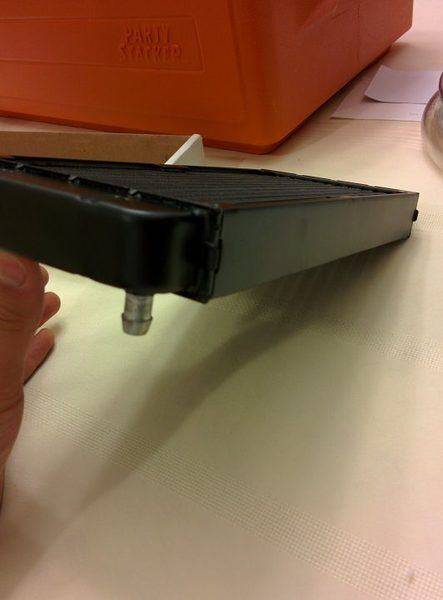

I don't think thermosiphoning is going to work for my application. This is meant to be done on the cheap <$100. And yes I only expect it last for an hour maximum. Those are my longest journeys in the car anyway. I need help wiring it as I am unsure how I should have it wired and if I need a fuse or not.

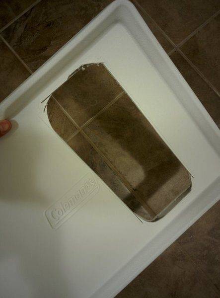

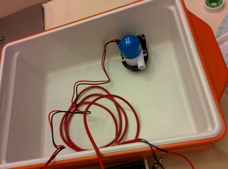

To give you an idea, the water pump will sit in the bottom of the cooler, I will cut out an opening in the lid for the radiator to be glued in and the fans will sit on top of the lid where the radiator is integrated. The cooler holds about 3 gallons.
I can't think of a cheaper system than a scrap radiator and its hoses and some tape with (cheap plastic) plumbing fittings top and bottom of your cooler tank. A pump involves another electric motor and another pair of waterproof joints.

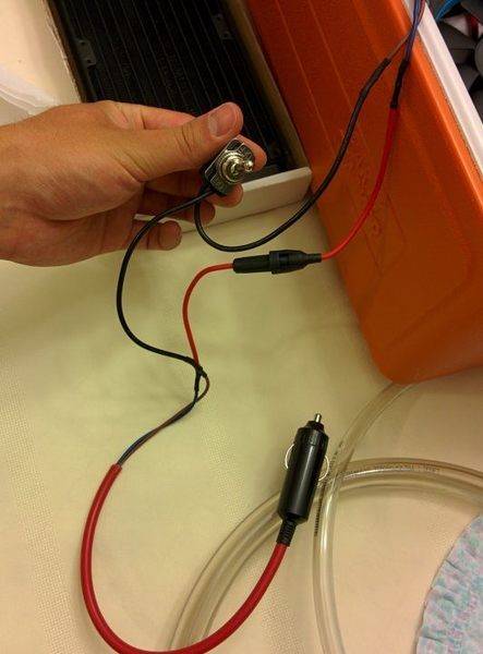

And YES! you must have a fuse, right next to where you take the power off. Changing that fuse could be a lot easier than getting under the bonnet (hood) to change the fuse in the car's electrics. :smile:

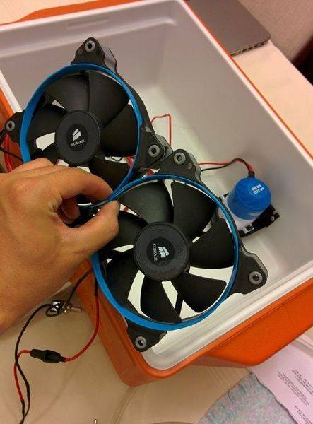

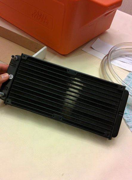

Yeah, I understand what you mean. The radiator is 11x6 inches. The two fans will cover than entire area. And the water pump is submersible. Literally just going to take vinyl tubing and hose clamp. It's not like its blasting 2000psi through the lines. It'll work. But say the car is 90F and id like it to be near 75F in the car. Cooler can only hold 3 gallons of ice water. This radiator that was in my computer on full load on the cpu was about 45F. While the regular heatsink and fan was near 65F on full load. Also the car is very small. A vw golf.

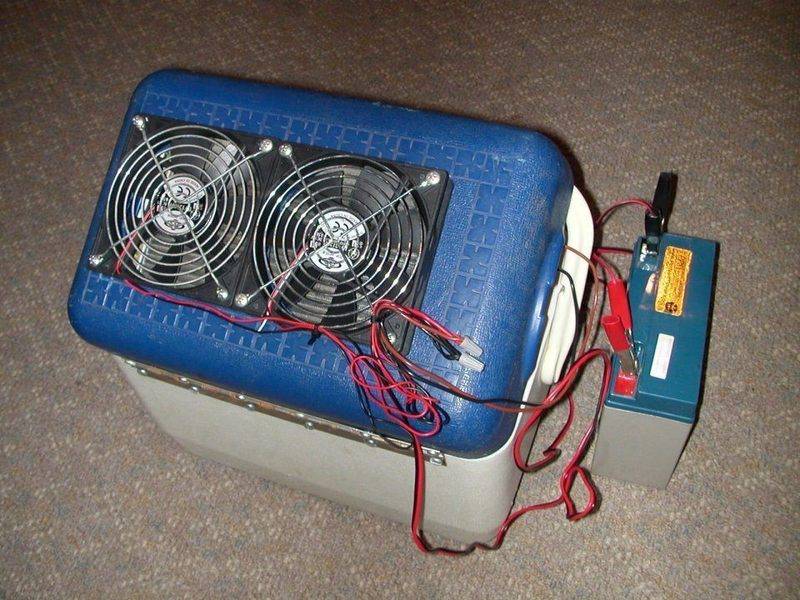

See the attached picture. That's exactly what I'm imagining. Minus the battery because those pos and neg will be connected to the 12v adapter for the cigarette. My cooler is a bit larger than that one. And oops correction: the rad on the cpu was 45C and heatsink with fan was 65C

Just bought an 8A fuse, that should be sufficient as I don't see the system going over 4 amps. Plus car fuse on the 12v line is 10A or 15A i think.
This is all well and good but a typical cooing system in a car will be the equivalent of melting several thousand pounds of ice per hour. Your cooler will only hold several tens of pounds of ice. Your order of magnitude is off by 2.
You have to realize you are driving around an uninsulated greenhouse. The typical calculations for room size assume that you have a well insulated space with only a small percent of windows.

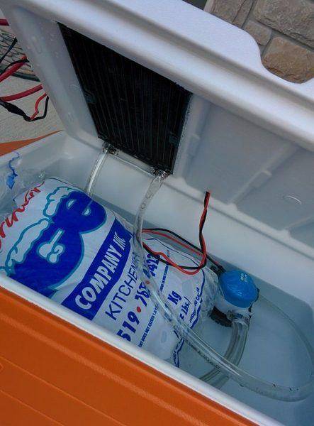

And for that reason, I will be building one this afternoon.
Weather permitting, of course. The morning clouds are predicted to burn off my 2 pm.
And my vehicle is black! This should be a good test.
I've also done some of the preliminary thermodynamic calculations.
3 gallons of ice water raised to 65°F will cool 896 m^3 of air from 90°F to 75°F

The sun decided to burst out early today. :partytime:
Currently collecting preliminary data.
