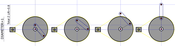

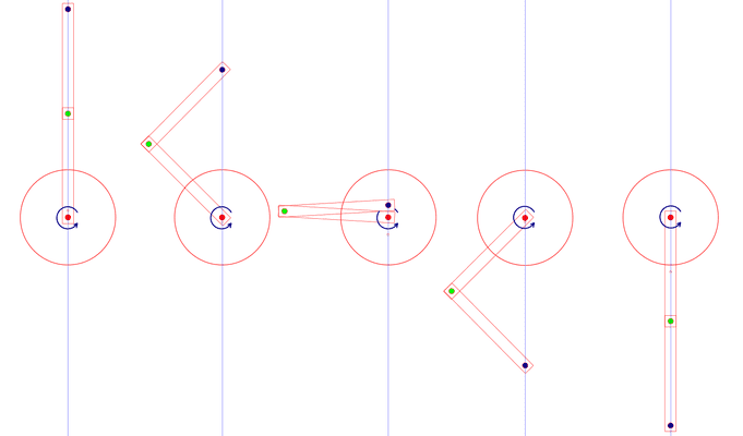

Hi, I am trying to design a lifting platform for light duty loads (3d printing build platform) that only uses rotation for its actuation. I have a design that uses a mechanism similar to the slider crank and I want to maximize the total height the platform can travel.
This is a sketch of my design:
The rotation is going to be executed by a motor at the red dot and my dilemma is about the behavior of the two arms when they reach the position at the middle of above image. I think this is called a singularity or dead point.
If the platform is going down, the way I have suggested in the sketch, at that point I see a weak mechanical position when the platform will tend to fall more than it should because of its weight. This is where I would loose precision in movement and I need a solution to overcome this.
A preloaded spring was suggested to me but I don't exactly know how should that be setup, to which direction is better? Is there any other (simple/cheap) solution employed by other such mechanisms/robot arms?
I am also thinking about having gears at the green dot ends of both arms but that would introduce backlash when the rotation would be reversed.
Thank you for your suggestions.

This slider-crank is very easy to build compared to a rack and pinion and the way I am going to move it requires this kind of design.
I would really want to find a solution based on the proposed design.
My only solution to avoid the singularity would drastically decrease my Z height capability. Please see the sketch below:
I don't really have much engineering experience so I need some suggestions based on my specific situation.

Mechanism as drawn will have numerous problems :
Very poor positional control - basically rattling loose at some crank angles and jamming at others .
Even if it was ok mechanically actually controlling it to make predictable incremental moves would be very difficult . Motion is not even basic SHM - there are big distortion terms to deal with as well and variable loads as seen by motor during an operating cycle .
Best to take advice of others above and use conventional drives .
Alternatively reconfigure machine so that heavy table is fixed in height and the much lighter work head moves up and down instead .
If you really need a bargain basement arrangement then use toothed belts .

If you want to let the slider move through the rotation center, as shown, I'm not sure how you get around its "indeterminate" motion.
Let's say the slider is exactly at the rotation center, and stationary. Now you turn the crank; which way will the slider go? It could go up or down, per your diagram. But the slider could also stay at the rotation center, since the crank arm and slider rod are the same length. How do you make it go the way you want? You really can't.
To make the slider go where you want, it needs to stay to one side of the rotation center.

One more question: if the initial position of the platform was up and it only descended, wouldn't the weight of the platform "help" it decide to go down at the singularity? This is what I was imagining at the beginning. The only problem would then be when I raise the platform all the way up, at that middle point it wouldn't choose to go above the center by itself, more likely it will go back down because of this weight bias.
For a crank and con rod to work in a stable and predictable manner the con rod has to be longer than the crank radius by a significant amount . Rule of thumb is that con rod length >= 2 crank radius . Or put it another way point of application of lifting force from con rod has to be outside the swept circle of the crank pin .
To expand on points mentioned last post the end motion of con rod in mechanism as drawn will be totally unpredictable at some crank angles and force acting on platform will be indeterminate for quite a large part of the full turn of crank .
The Video is nonsensical .
The only variation of your mechanism which might work within same amount of space is the Scotch crank .
