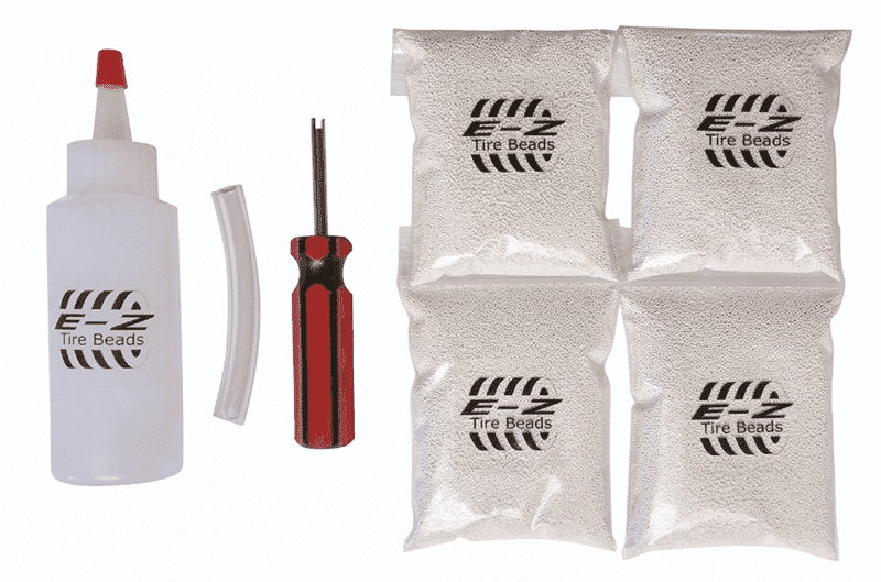

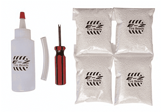

So for what it's worth (anecdotal, so not much :biggrin:) I installed some of these tire balancing beads in my poorly-balanced 33" off-road tires this past weekend. I bought this particular brand mainly because they were available with free same-day shipping through Amazon.
http://www.eztirebeads.com/
According to the manufacturer they are "high density ceramic beads," and came with an installation kit and filtered valve stems so the beads don't plug it up and cause a leak. The beads flow very easily and are very small, no more than 1.0 mm in diameter I would guess; I found installation to be straightforward but tedious. I installed 8 oz of beads in each tire (which is a bit more than recommended but oh well) and it took quite a while, because the valve stem with the core removed only allows a very slow flow of the beads without getting plugged up. It took me about 30 minutes per tire which was annoying but partly because I was putting in so many.
The result is better than I expected actually! I think probably not better than a well-balanced tire from a dynamic balancing machine, but the ride is miles smoother than previously so if the option is no balancing or these I would definitely use the tire beads! I tested them out by driving around both in-town (~30-45 mph) and on the highway (~70 mph). With these tires previously you wouldn't notice obvious vibration until about 25 mph, and now I'd say I only notice a little vibration initially around 25 mph but then things smooth out; I'm guessing it's the beads re-positioning in the tire after each stop. I find the ride to be even smoother at higher speeds, and since that's where the balancing matters most I'm very happy.
So, the tire balancing beads do appear to work in my tires. Your results may vary.
