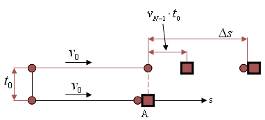

A cannon shoots bullets of mass m0 and velocity v0 at a massive log of wood of mass 100m0. the interval between the bullets is t0. the surface is smooth. the bullets are stuck in the wood. the penetration time of the bullets is very short, relative to t0.
1) What's the log's velocity after the first bullet.
2)What's the log's velocity after N bullets.
3) Express the number of the bullets in the log as a function of it's velocity.
4) How much heat energy was created in the log after N bullets.
5) How much time elapsed between the N-1 bullet hit and the Nth bullet hit.
6) How much time elapsed between the first bullet's hit and the Nth bullet's hit.
7) When does the log's velocity equal 0.5v0.

The distance the log travels between the (N-1) and the Nth bullets is:
$$\Delta s=v_{N-1}\cdot t_0=\frac{(N-1)v_0t_0}{99+N}$$
The time between two subsequent bullet hits is not to. to is the time between the shots. The bullet hits the log between the shots, and before the (N-1)-th hit the log travels with VN-2 velocity, after the hit it travels with VN-1. To get the distance the log travels between the hits is quite complicated.

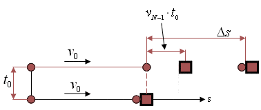

I am beginning to understand but not yet. if i use:
$$\Delta s=v_0\cdot t_{(N-1)\rightarrow N}=v_{o}\cdot t_0+v_{N-1}\cdot t_{(N-1)\rightarrow N}$$
Then my drawing isn't adequate, it's adequate only for my formula:
$$\Delta s=v_0\cdot t_{(N-1)\rightarrow N}=v_{N-1}\cdot t_0+v_{N-1}\cdot t_{(N-1)\rightarrow N}$$

Exactly, that's what i understand, but what's the physical reasoning for the member ##v_0t_0## instead of ##v_{(N-1)\rightarrow N}t_0##?
Mathematically it adds my missing t0, but i don't see the physics of it. is it just a mathematical trick? if so, how did you do this, how did you know in advance what to do (if it's merely a mathematical trick, with no physical meaning)?
Edit: i think i am beginning to understand, you translated time to distance, there is no complete physical meaning. you need to get t0 plus something, so for the first t0 you need a distance of ##v_0t_0##, is that correct?
The N-th bullet arrives to the place of the N-th impact t0 time later than the previous impact was. From the place of N-th impact, the N-th bullet moves with v0. The log is at distance VN-1to already. So the time the N-th bullet reaches the log is ##\frac {t_0 V_{N-1}}{v_0-V_{N-1}}##. You have to add t0 to get the time between the impacts. It is ##\frac {t_0 V_{0}}{v_0-V_{N-1}}##
You must mean that the N-th bullet arrives to the place of the (N-1)-th impact, right?
Any way, you must mean point A in the drawing, right?
##\frac {t_0 V_{N-1}}{v_0-V_{N-1}}## must be from the point of view of an observer riding on the log, and the observer sees the distance ##t_0V_{N-1}## closing with the relative velocity ##v_0-V_{N-1}##.
All this is correct but how to get from here to:
I don't know.

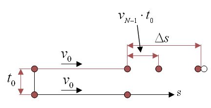

This is how I see it.
Imagine a pretty accurate machine that shoots bullets, Now at an instance, the bullet number #1 for example was shot. After ##T_o## The bullet number #2 was shot. So the bullet number #1 moved with velocity ##V_o## for a time of ##T_o## before the bullet number #2 was shot. So ideally the distance between them will be ## d = V_o t_o##
Now does the distance change? Nope... The velocities are equal to each other so it is fixed along the distance that they move.
For our N bullet and N-1 bullet. Skip the whole scene of N-1 catching the log. Once the N-1 bullet hits the log, What is the distance between the log and N's bullet? Remember what we said above.
What is the velocity of the log now? What is the velocity of the bullet? Calculate the time needed for the bullet to hit the log.
It is just the same as the cop and the thief examples. They have initial distance and the cop's car have a fast velocity compared to the velocity of the thief. (Poor Thief)
What you were doing wrong is when you calculate the distance you were using ## V_{N-1}## not ##V_o##
Yes. And the Nth bullet catches the log after covering distance Δs
##\Delta s=v_0\cdot {\Delta t }=v_{N-1}\cdot t_0+v_{N-1}\cdot \Delta t##
from what you get the catch time
$$\Delta t=\frac{V_{N-1} \cdot t_0}{v_0-V_{N-1}}$$
The Nth bullet arrived at the place of the N-1th impact t0 time later than the N-1th bullet. So the time between the two impacts is
$$t_{(N-1)\rightarrow N}=t_0+\Delta t= t_0+\frac{V_{N-1} \cdot t_0}{v_0-V_{N-1}}=\frac{t_0(v_0-V_{N-1})+ V_{N-1} \ t_0}{v_0-V_{N-1}}=\frac{t_0 V_0}{v_0-V_{N-1}}$$
