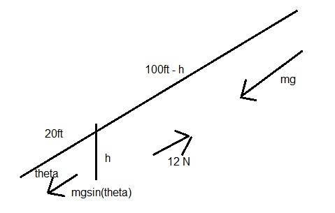

I think the approach you've used can be described in this way (as noticed, the rope and its K constant seem to be irrelevant):
The considerations being taken into account are: a change in the ''roughness'' of the floor and a change in the magnitude of the force down the slope. I think your simulator is accounting for a lost of thermal energy because it is truly considering the problem as one of a person falling. Then, what we're just considering as a change in roughness when going from the ##100ft-h##-floor to the ##20ft##-floor, the simulator is considering it as an impact, where the Normal Force is not mgcos(theta) and the downward acceleration is not mgsin(theta) when he first hits the top of the slope of 20ft.
By Newton's Second Law I find the accelerations in each section and then their velocities usign kinematic formulas. The final one at the bottom agrees with that you've found, but I suspect is not the right way to solve the problem but one where an impact is taken into account (I have no clue about how to do it).

I can't relate your diagram to the given facts. He falls vertically 100ft (yes?) onto a scooter at the top of a 5 degree ramp length 50ft. The 20ft is irrelevant.
Note that the velocity with which he hits the scooter does not become an initial velocity down the slope. The component of it normal to the slope will be lost as thermal energy.
I agree there is no force exerted by the rope. Just gravity and air resistance during the fall. In the absence of any initial velocity, I would treat it as a purely vertical fall. The velocity at the end of the fall could be found with
I assumed the 100ft-height is measured from the ground. While falling there is a net acceleration ##a##, which is a little less than that of gravity (because of air resistance, which I assumed constant).
The acceleration has that magnitude until he hits the top of the slope. Here, the last chunk of the 100ft-path is not traveled with the acceleration ##a##. That's why I subtracted h from 100ft.
I confused 20ft with 50ft. The latter is the correct. I will recalculate it.
As far as I understand, Ncos(theta) remove some of the speed that goes into thermal energy, so there is no conservation of energy, but how long does the overall apparent weight act? or how can the distance along which it does work be figured out?
