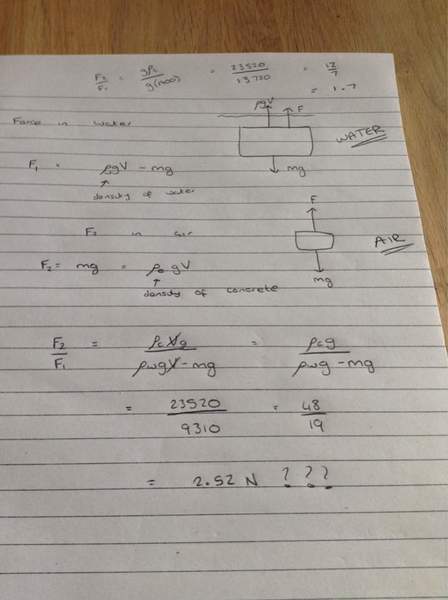

Ok I had another look at the problemF1= gV(φ -ρ) the force to raise it to the surface?
And F2= gVφ
The force or raise it in air?

Horror. Look at what you are doing a little longer. That way you can make do with one post instead of six, and we can handle the entire thread in three or four posts instead of over sixty! Slap, Slap, Slap :smile:
You are asked for F1 / F2. I don't know why you change notation so often, except perhaps you like to torture yourself.
On your sketch, F1 clearly points the same way as ##\rho_w\, gV##. If you want to write a balance, write F1 + ##\rho_w\, gV## = mg . Is that clear enough ? Read it over if it is not, don't quick reply.
In the next step, you can write F2 = mg = ##\rho_c\, gV##. Perhaps it is wise to use the same expression for the same thing. Why not change mg in the first to ##\rho_c\, gV## as well ? Less confusing, for you too.
In the ratio, you happily divide the numerator by V, but only the first term of the denominator. Aaaargh!
Then you swap to numbers, the last resort. A bit too early. To make up, you slap a dimension of Newtons on the quotient. No good. A ratio is a ratio and a force is a force. A ratio of forces is only a ratio and not a force.
Now, please please, write F1 / F2. Divide out properly and get something extremely simple.

Oh ok soF1 + ρgV = mgAnd this is the force in water? I'm just trying to get this as clear as I can sorry F2= mg = ρgV And this is the force in air and I want the ratio of
F1/F2
However in my first expression I can write mg as ρgV but that would be the density of concrete the same as the density in the second expression
So I would have
ρ(concrete)gV- ρ(water)gV = F1And F2= ρ(concrete)gVSo my expression becomes
ρ(concrete)-ρ(water) divided by ρ(concrete)

And when I plug my numbers in I get
7/12Or0.583
  • #66
No need to apologize, and yes: you make me feel really happy by picking up the right thing!
In the end all you have is $$\rho_{\rm concrete} - \rho_{\rm water} \over \rho_{\rm concrete}$$ or indeed 14/24
