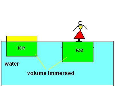

1. A slab of ice floats on a freshwater lake. What minimum volume must the slab have for a 45.0 kg woman to be able to stand on it without getting her feet wet?
2. Archimedes Principal as well as Newton's Second Law will be applied
I know that the volume of water that is being displaced will equal the combined weight of the woman and the slab that is pushing down on the water.
This gives the equation:
ρVg = Weightwoman + Weightice
***ρVg is the same as [itex]\frac{m}{V}[/itex]***
Applying this gives:
ρVg = g(45.0-kg + mice)
ρV = (45.0-kg + mice)
I know that the density for the freshwater lake will simply be 1.00 x 103 kgm-3 and the density for ice will be 0.92 x 103 kgm-3.

Do you know what V means? The volume of what? What displaces the water? The feet of the women can not be wet, so she is not immersed, she does not displace any water.
ehild
ehild
I apologize. The V, in this case, is referring to the volume of the water that is being displaced by the woman's weight on the slab of ice.
The water is displaced by the immersed volume of a floating body. The volume of he displaced water is the same as the volume of the immersed part of the body. See picture. It shows the slab of ice. It is partly immersed in the water (the green part) but totally if the woman stands of it. But the women is outside of the water!
If the women stands on the ice the total volume of ice is immersed. How do you get that volume of ice from its mass and density?
The volume of the immersed part of a body displaces water of equal volume. The weight of a floating body is equal to the weight of the water displaced, the volume of the immersed part multiplied by the density of water and g.
Here the weight of the ice + woman must be equal to the weight of the water displaced. The volume of the displaced water is the same as the volume of ice immersed, it is the total volume of ice now.
m(ice)+M(women)=V(ice)ρ(water)
But you know that m(ice)=ρ(ice)V(ice):
ρ(ice)V(ice)+M(women)=V(ice)ρ(water)
isolate V(ice).
ehild

Here I am slightly confused. I thought that it should be ρ(ice)V(ice) = ρ(water)V(water)
(920 kg/m3)(45kg + X) = (1000 kg/m3)x
Solving for x should give 0.5625 m3.
I am still slightly confused by this problem.
So I've been thinking a bit more about this problem. And I realized the following.
1) The volume of water being displaced should equal the volume of the ice because the slab of ice is completely submerged within the water. The weight of the woman acts as an outside factor, keeping the ice submerged.
2) The Buoyant Force exerted by the water will be acting upward and will thus be supporting both the woman and the slab of ice.
We already know that the Buoyant Force exerted by the water should equal to the ρwaterViceg.
We are tasked with finding what Vice is. Picture a free body diagram for this question. There will be a buoyant force acting upwards as well as a force, weight, acting downwards. This force is equal to (mwoman + mice)g.
And we can set them equal to one another, giving:
ρwaterViceg = (mwoman + mice)g.
ρwaterVice = (mwoman + mice)
mice) = ρiceVice
∴ ρwaterVice - ρiceVice = mwoman
Vice = mwomanwaterVice - ρiceVice
And plugging in the values gives the correct answer.

The weight(mass) of ice is not the same as the weight (mass) of the women. You need the volume of the ice slab. It is unknown, denote it with something, say V.
The ice with the woman on it will float if the buoyant force is equal to the combined weight of ice and woman.
If V is the volume of ice, the mass of ice is ρ(ice)V=920 V.
You get the buoyant force if multiply the the displaced mass of water by g. If you immerse an object of volume V into water it displaces V volume of water.
So the weight of ice+woman= buoyant force →ρ(ice)V+45=ρ(water)V

If you you meant
Vice = mwoman/(ρwater - ρice)
then it is correct. :smile:

What do you mean by THAT part of the floating object. As in, for the question we did above, the ice was the part that was immersed, therefore it's volume was that of the volume of liquid being displaced? I think I understand now.
As an example, the ice would not be immersed into the water totally without the woman.
You can find the immersed ratio by calculating the buoyant force as V(immersed)ρ(water)g. That is equal to the weight of the ice: ρ(ice)V(ice)g.
So V(immersed)/V(ice)=ρ(ice)(water)=0.92. 92% of an iceberg is immersed into water so only a small part is seen, that is why the Titanic sank...(in case of seawater a bit less is immersed, as the density of the salty water is higher)

That is actually quite interesting :) And because the woman is standing on the ice, it is submerged in at 100% correct? Without her standing on it, it would only be at 92%. Oh, and Vimmersed is simply referring to the slab of ice that is in the water, it's not referring to something specific, therefore we don't have an exact specific value for it, correct? I am sorry for the questions, I'm just trying to thoroughly understand this!
And the equation you used is simply setting the volume of the Buoyant Force being exerted by water to the weight of the ice?
Yes, you are going to fully understand floating:smile:

And just one more question (for now!), the equation you have used is the Buoyant Force (the product of the density of water, gravity and the volume of ice? that has been immersed) that is being exerted by the water = the weight of the slab of ice, which can be found by the density of the ice, the Volume of the ice, and the gravity?
The immersed volume of ice which is the same as the volume of water displaced.
