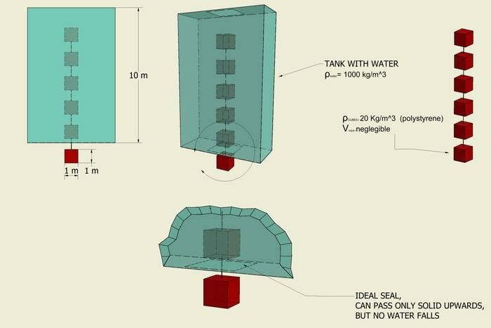

Hi guys, i will propose you the problem in another way, More clear, and images.
I have a tank with water (10 m hight) , with an ideal seal at the bottom (water can't fall down, but can enter bodies).
I have a system of 6 cubes ( of plystynere) with dimension 1x1x1 m.
These cubes are connected with a rope (volume negligible).
As you can see in this image:

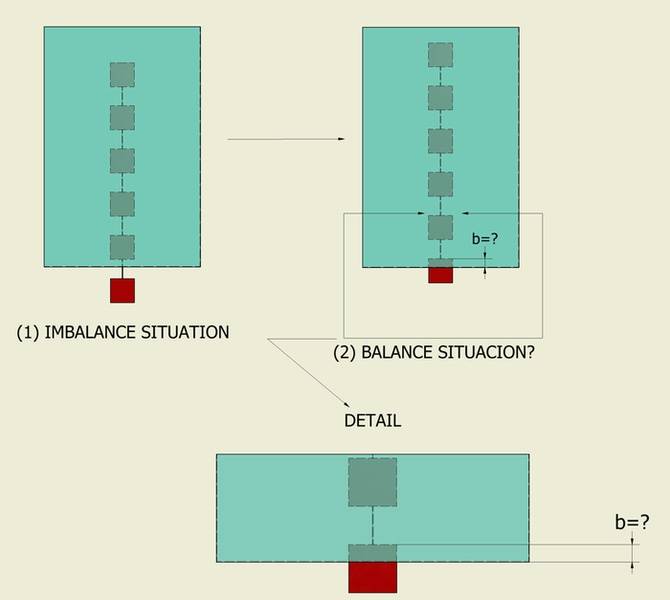

In the next image i have a situation (1) which is unstable.
My question is:
in a stable situation it will be as in the balance situation (2) (see upper figure),
and...if the answer is yes... how much will be de measure b? (and how you reach that result...).
I will post a video too, just the clear you the scene.
Thank you for support and helping!

Assuming you have that magical seal that allows a mass to extend below the bottom water line, the result will be unstable. The further downwards that the extended mass is, the greater the amount of pressure from the water since the pressure increases with depth.
To create a stable situation, you'd need a lower density mass floating at the upper surface of the water, supporting any higher density masses below it.
Yes in the first image is unstable, i ask for the stable situation in the second image.
The buoyancy force of the cubes pulls up, but the pressure at the bottom will resist for the bottom cube. The resultant of these forces will permit the cube to penetrate a little?
If yes...how much?
I need the b measure in the stable situation and the steps to get it.
Kamira said:
I ask for the stable situation in the second image.
It's not stable, assuming that the second image is a boundary state, if the mass moves up, it continues to move up, if the mass moves down, it continues to move down. There's no self correcting tendency for the mass to remain at the position in the second image.
Due to the use of cubical shapes, there is a discontinuity in the system. If the top surface of the bottom cube is just below the seal there is no pressure on it. If the top surface of the bottom cube is just above the seal there is full pressure of water-at-depth on it.
That means that the point of stability (if there is one) is almost certainly with the top surface of the bottom cube exactly at the seal. This is the point of discontinuity. The pressure on the top surface of the bottom cube is undefined at that point.
If instead of cubes one used spheres, no such discontinuity would exist.

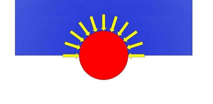

You can calculate the force on a submerged object in a number of equivalent ways.
For instance, you can add up the pressure on all of its surfaces due to the fluid in which it is immersed. Call this the "pressure approach". Or you can calculate the volume it displaces, multiply that by the density of the fluid and the acceleration of gravity. Call this the "buoyancy approach".
The diagram that you show above lends itself to the pressure approach. But that's difficult to calculate. The pressure is not uniform -- it varies with depth. And the pressure is not all in the same direction.
So I chose to use a hybrid approach. Compute the supporting force that would be present due to buoyancy and then subtract the pressure on the cross-sectional area where no supporting fluid is present.
So the net force on the partially-inserted sphere is equal to the buoyancy that the portion inside the chamber would have experienced minus the pressure of fluid-at-depth that would have been present on the bottom surface if you had chopped the sphere in two right at the seal.
We can call the approch as we want, but an half sphere in the bottom of a tank doesn't experiment any buoyancy, no force thant pull upwards.
The only force due the water is pushing the ball down.

If we discard the labels on the forces, do you agree that the net force on five fully immersed spheres plus the one half-immersed sphere at the bottom seal is equal to the buoyancy that five and a half spheres would have minus water pressure at the depth of the bottom seal times the cross-sectional area of the bottom sphere at the seal?
Kamira said:
We can call the approch as we want, but an half sphere in the bottom of a tank doesn't experiment any buoyancy, no force thant pull upwards. The only force due the water is pushing the ball down.
You have the pressure from the atmosphere pushing up on the ball from below, but the pressure from the atmosphere is less than the pressure of the water except at the upper surface of the water.

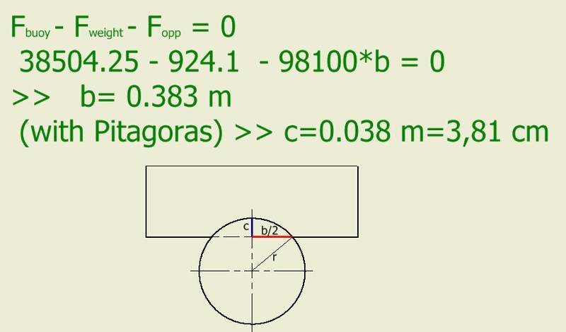

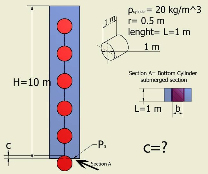

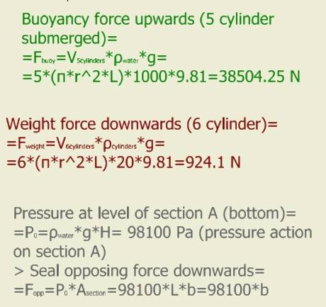

Trying to do calculation (and using cylinders and real case)...
I think (hope) that's correct.
jdbriggs?
Your computation for the upward buoyancy force from the five fully immersed cylinders appears correct. 38,500 Newtons is what I get as well.
Your computation for the downward weight from the six cylinders appears correct. 924 Newtons is what I get as well.
I do not understand your wording for "seal opposing force downwards". The forces that I see being applied on the partially immersed cylinder are:
1. Water pressure over the curved upper surface
2. Air pressure over the bottom surface -- this cancels out and we can consider it to be zero.
3. Force from the seal -- but the seal is ideal, so this is zero.
4. Upward force from the 5 tethered cylinders above -- but that's already being accounted for.
5. Weight -- but that's already being accounted for.
So the figure you are trying to quantify is water pressure over that curved upper surface.
As an approximation, you could consider that the pressure over that surface is constant and is equal to 10 meters of water head -- 98100 Pa. I will assume that this is what you are doing.
With this understanding, your equation for the water pressure on the top of the partially immersed cylinder is what I get as well.
Solving for the value of b for which the upward and downward forces balance, I also get 38.3 cm.
Applying the pythagorean theorem, I agree that you get c = 3.8 cm.
With that value in hand, you can put a bound on the error that was introduced by approximating the pressure on the upper surface of the cylinder with a constant. [This is the "buoyancy" factor that we had vigorously discussed]
I get that b will only go up to 38.4 cm at most with that factor accounted for.
