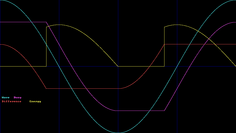

Here is a graphical model of how a simple double acting buoy pump operates. As a sufficiently large wave passes, the float (magenta) follows the wave (cyan), but with a lag because the buoy must apply sufficient buoyancy force to move the pump. The height difference between the wave surface and buoy is plotted (red). Notice that energy (yellow) is only generated while the buoy is displaced by the fixed offset, and that it is proportional to the slope of the wave. No energy is generated while the wave height is crossing the buoy height as the buoy does not move.
In order to generate energy continuously it would be necessary to employ a minimum of four buoys, separated by 1/8 of a wavelength.

This is good graph and information. What I learned from it is, about 4 buoys can be used to continuously pump the water at some level.
I'll perform the simulation of this sometime soon and see how it turns out.
The simple step by step simulation I used to generate the graph is attached as a text file.
