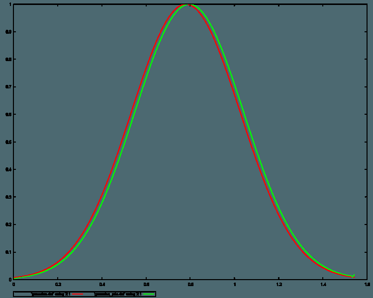

I tried to used the Crank-Nicolson method to solve the advection equation for a Gaussian pulse using the code on this page and I'm lost at trying to setup the initial values for the Gaussian which is passed as an array into the advection matrix.
The Gaussian pulse is defined
initial condition: u(x,0) = exp[-100(x-0.5)^2] as on this page written for the Lax method.
The initial velocity is v = 1, timestep = 9.95x10^(-3), N = 200 and C = 2.
In the following code the matrix u is initialized to 202 elements and I try to initialize the matrix u
with the gaussian pulse for each index between 1 and 200 but something is very wrong. For one I'm not sure how to put the timestep into the gaussian equation. I suppose if x/t = v then tv = x and (9.95x10^(-3))*(velocity = 1) = distance then each timestep solved with advect1D would move the Gaussian to the right a small amount.
The thing I'm not sure about is this part in my code
Code:
for (int index = 1; index < 201; index++)
        u(index) = exp(-100*(distance - 0.5)*(distance-0.5));
I initialize every element of u(index) with the same gaussian? Well hopefully someone can help me here's the complete code.

I made some changes to the code and I think I solved it but I'm not sure the solution makes sense. Basically I create a Gaussian pulse function with
width (standard deviation) = 0.247
height = 1;
position = .78
the actual width of the Gaussian is 1.55 from tail to tail and I divide that number by 200 to get the space discretization which is used to find the value of the Gaussian at specific intervals between 0 and 1.55. I output the original Gaussian and the advection equation into a dat file and use gnuplot. Now I'm not sure if the solution I found is correct. I think it makes sense, any ideas?
Heres the source and the gnuplot .plt file below it plus a photo of the beast.

What I find irritating at a first glance is that the arrays for the a,b,c diags are of equal size, thus two of them are padded; I'd doubt this improves efficiency or simplifies usage significantly.
Furthermore:
Let T be your Matrix with a,b,c diags.
From http://farside.ph.utexas.edu/teaching/329/lectures/node92.html
Code:
// Invert tridiagonal matrix equation
  Tridiagonal (a, b, c, w, u);
i take it one should solve
T * u = w
for u by inverting T in the Tridiagonal function.
boost::ublas has an adaptor for banded matrices
http://www.boost.org/doc/libs/1_53_0/libs/numeric/ublas/doc/banded.htm#banded_matrix
and LAPACK of course has this as well
http://www.netlib.org/lapack/lug/node125.html
Have you checked the correctness of your own Tridiagonal function with either of them?
Regards, Solkar
