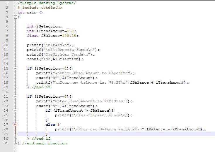

Hello
Please I am practicing my simple basic C Programming using Notepad++ and Cygwin64
I have written tried running the codes in the picture below, it doesn't detect any error when I run it but when I try to 'withdraw some money less Tha the fBalance, it still displays the result insufficient funds, instead of my expected 'You new balance is ... '
I've tried checking what I missed but couldn't find any. Apparently I am still a newbie in the language.
Any suggestions please.

Sorry, but w/"code" tags, not clear on that. But I have copied the code directly now. Please be free to comment on any other aspect of the code presented below.

C:
/*Simple Banking System*/
# include <stdio.h>
int main ()
  int iSelection;
  int iTransAmount=0.0;
  float fBalance=100.25;
 printf("\n\tATM\n");
 printf("\n1\tDeposit Funds\n");
 printf("2\tWithdaw Funds\n");
 printf("\nEnter your Selection:");
 scanf("%d",&iSelection);
  if (iSelection==1){
    printf("\nEnter Fund Amount to Deposit:");
    scanf("%f",&iTransAmount);
    printf("\nYour new balance is: $%.2f\n",fBalance + iTransAmount);
  } //end if
  if (iSelection==2){
    printf("Enter Fund Amount to Withdraw:");
    if (iTransAmount > fBalance)
    printf("\nInsufficient Funds\n");
  else
    printf("\nYour new Balance is $%.2f\n",fBalance - iTransAmount);
  } //end if
} //end main function
You have declared iTransAmount as type int, but your calls to scanf() are using the wrong conversion specifier for an int. Both of your variables for money should be float or both double, but not int.
I see that you are using Hungarian notation (iSelection and fBalance), with "warts" at the beginning indicating the type. I believe that was a fad that came and went some time ago.
Likes Simon Clement

Comment in addition to those in my previous post -- The else above is indented so that it appears to be paired with the outer if. It isn't. It goes with the if just above it, so should be indented at the same level. The compiler can figure this out, but people reading your code (not "codes") might be thrown.

Thank you very much Mark44. The mistake was in the conversion specifier I was using to call my iTransAmount, like you mentioned. I have replaced the %f in the scanf functions with %d and everything works fine now. Really grateful.
I have also taken note of your comment on the last 'else' indentation, the code tags and on the code (not "codes").
