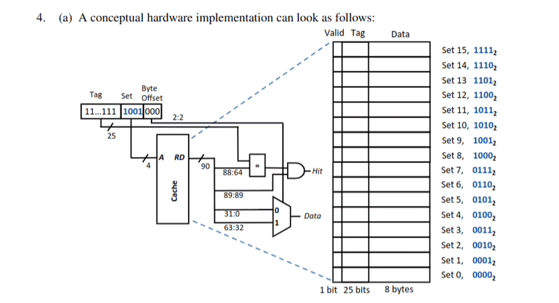

Something that I can't seem to find a good explanation of online is how the "byte offset" field in the cache address is used practically.
For example, take this example from the course I am currently taking:
Assume that we have a 32-bit RISCV processor with a direct mapped instruction cache.
Assume further that the number of sets (also called rows) are 16, and the block size is 8
bytes.
Draw the hardware implementation for reading from the instruction cache.
In this example, we have a direct-mapped cache, and this cache has 8 bytes per block. So the number of bits in the byte offset field is ##\log_2(8)=3## bits.
The question asks for a hardware implementation of the cache. While there are 8 bytes stored per block and the byte offset field can take any value from 0 to 8, in the solution key, the byte offset field is wired to a MUX with only two inputs (0 and 1), and we only use bit 2 of the byte offset field in practise. See the screenshot of the solution key below and look at the MUX wired to byte offset, and you'll hopefully see what I mean!
If I read my course book, they have an example (Figure 8.7) where they instead of 8 bytes have a similar direct-mapped cache, but with 4 bytes (1 word in their context) in the data field. Since they have only one word in each block, they say: "the byte offset bits, are ignored for word accesses."
So, even though the byte offset field in theory for a cache storing ##m## bytes of data can take on values ##0,1,...m## caches will generally return the whole word that the passed byte offset is associated with? For example, returning to the question I mentioned in the quote above and the 8 bytes data per block, accessing addresses on byte offsets 0,1,2, and 3 would all return the same data from the cache, it would return the whole least signifcant word stored in the block.

bremenfallturm said:
I hope my question is understandable:)
Not really, and in any case the answer is implementation dependent. Refer to your course materials or the datasheet for the specific hardware implentation (if any).
Ah, sorry for not getting my point across. Anyways, I will simply assume that the case for the implementations my course has been discussing is that the cache returns a word at a time, regardless if the byte offset points to the beginning of a word in the cache or not.
