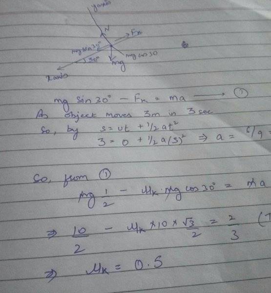

A particle of mass M is released from rest on a rough inclined plane, which makes an
angle of 30° with the horizontal. It is observed that the particle moves a distance of 3 m
in 3 s. What is the particle’s acceleration? Draw a properly labelled free body diagram.
Calculate the coefficient of kinetic friction between the particle and the surface of the
inclined plane.
i made the equation of force with the help of formula F=mg. Equation i made was mg*sin 30 - kinetic friction force = ma
i calculated coefficient of kinetic friction by tan 30 = 0.58
then i used equation mg.sin 30 - mg.cos30. 0.58 = ma.
m got divided on both sides but i am getting value of a -0.02 something so what does that mean? acceleration is negative? mass is going up instead of down? its very confusing please help me.
also how to use data it moves 3m in 3sec. why its given?

yea, i read the forum rules, sorry fr my ignorance. but the problem is i am not able to arrive at final solution. i tries to create 2 equations by taking the slope of inclined plane as x-axis and normal as y-axis but still i wasn't getting adequate data to solve 2 variables. it still requires coefficient of friction value. idk where am i going wrong i have skipped this question for now from my assignment. can you at least please tell me what would be those two equations that would be a lot of help and don't we have to use the data 3m in 3s? Thanks a lot :) hope i get a solution this question really troubled me a lot xD

Hi, sorry for late reply. Was busy with my assignments. I did the solution this way in the pic below pls tell if its correct. I feel I can't use equation of motion here which I did.
Looks good to me.
What you did was fine. What bothers you?

thx for verification, i was thinking i can't use equations of motion here as they are for 1-d motion but here we are working in 2-d plane. Also can u please tell me why do tan theta = coefficient of friction was not working here? what was i doing wrong there? thanks
If you have 2D motion, then you have the equations of motion separately in each direction. You could solve this problem by taking the horizontal and vertical directions as your two axes. But, that would be more difficult.
What you did, therefore, was to take the direction down the slope as one axis and the normal direction as the other. This effectively reduced the problem to 1D motion. Why? Because the particle is constrained to move down the slope, so there is no motion in the normal direction.
Why should ##\mu = tan \theta##? That means friction would be dependent only on the angle. So, friction on an icy slope of angle ##\theta## would be the same as friction on a rough slope of angle ##\theta##.
What you might be thinking is that the acceleration down a slope is related to ##\mu## and ##tan \theta##. You might like to try to derive that relationship.
The context in which that equation applies is constant speed. Most usually, it is applied where the particle is on the point of sliding, and it's μs.
