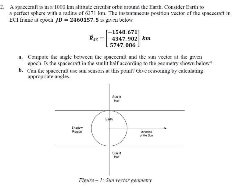

Hi, so I have no clue how to solve this problem but I started off by rewriting the issue as a dot product to find the angle. So;
cos(θ)= RSC⋅RSun / ∣RSC∣⋅∣RSun∣
Where Rsc = space crafts position vector.
Rsun is the Suns position vector.
∣RSC∣ is the length of the spacecrafts position vector.
∣RSun∣ is the length of the Suns position vector.
So in order to get the angle I planned to take arccosine.
But how do I get Rsun?
Is this a correct approach?
Am I doing something wrong or maybe theres a better approach to the problem?
Welcome to Physics Forums!
It looks to me that you'll have to find the vector between the Earth's center and the Sun for the Julian date given (JD = 2460157.5). Perhaps your book will have a procedure to find this?
By the way, what is the book you're studying?

Hi. Not my area but I'd say it's a (the?) correct approach.
A search for "find sun's ECI coordinates from Julian date epoch" gives some potentially useful results.
