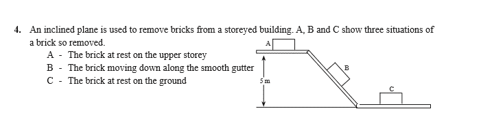

Calculate the velocity of the brick at the bottom of the inclined plane.
State the assumption you made for your calculation in part above.
& Sketch the displacement-time graph relevant to the movement of the brick along the smooth gutter. (Assume that the brick started to move from the state of rest.)
Workings:
I am unable to think on the first two but I think the displacement and time graph should be something like ,
Many Thanks :)

To calculate the velocity of the brick at the bottom of the gutter, I would take the statement that the gutter is smooth to mean there is no friction, and so conservation of energy can be applied. When the brick is at the top of the gutter, it has gravitational potential energy, and since it begins from rest it has no kinetic energy. Then when the brick is at the bottom of the gutter it has kinetic energy, but no gravitational energy. The amount of energy stays the same, but it changes from potential energy to kinetic energy.
So, if we equate the initial potential energy to the final kinetic energy, we have:
$$mgh=\frac{1}{2}mv^2$$
What do you get upon solving for $v$?
$$2kg * 10 ms^-2 * 5 m=\frac{1}{2}mv^2$$
$$2kg * 10 ms^-2 * 5 m=\frac{1}{2}*2kg * v^2$$
$$100 J= v^2$$
$$10 J= v$$
Correct ? :)
I would solve the equation first, and then plug in the numbers:
$$v=\sqrt{2gh}$$
Okay, at this point we can plug in:
$$g\approx9.81\,\frac{\text{m}}{\text{s}^2},\,h=5\text{ m}$$
$$v\approx\sqrt{2\left(9.81\,\frac{\text{m}}{\text{s}^2}\right)\left(5\text{ m}\right)}=3\sqrt{\frac{109}{10}}\,\frac{\text{m}}{\text{s}}\approx9.9045\,\frac{\text{m}}{\text{s}}$$
