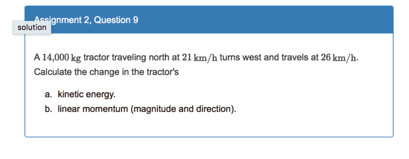

I have attached the problem.
A 14,000 kg tractor traveling north at 21 km/h turns west and travels 26 km/h. Calculate the change in the tractor's
a. kinetic energy
b. linear momentum (magnitude AND direction)
[/B]

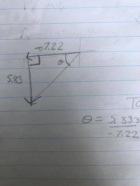

b) This part is where I get lost... The change in linear momentum is the same thing as impulse. Impulse is m(vf-vi) --> I know I cannot just subtract the velocities that are given because they are not in same direction. They have direction and magnitude. I must use vectors to find the vf-vi.
In vector notation, vf-vi is that same things as saying vf+(-vi)
Turns out that the initial velocity only has a y component, which makes its velocity (after computing with the vectors) = 5.83 m/s
The final velocity only has an x component and a 0 y component, which makes its velocity ( after computing with a y and x component) = -7.22 m/s
After getting this far, if I did it right, I assume that now I must do another vector problem with the vector final + (- vector initial)
I draw the final vector in the negative direction (west) and lable it with -7.22, then I flip the direction of the north vector (v initial) making it south to subtract from the v final. I get a vector pointing west, plus a vector pointing south. I draw an arrow from the tail of first to tip of last.
I then have a right angle, do pythagorean theroem to find
86.1173 = resultant^2 ... I take the square root to get 9.27
Is this value vf-vi?
If so, I multiply this by the mass of the truck to get the change in momentum?
So... (9.27) * 14000 kg = 1.30*10 ^5 kg*m/s
To get the direction, I do the arctan of what values? Is it the velocity of final/intial??

Okay so I would use the values though for the velocity? Because momentum is in the same direction as the velocity right?
So it will be the arc tan of (initial velocity / the final velocity) (I drew out the triangle and tan is the opposite over adjacent)
The opposite is the velocity initial and the adjacent is the velocity final.
So theta = arctan(5.833/-7.22) ?
Does this seem correct?

No. Can you show the drawing ? In which quadrant does the vector ##\Delta\vec v## end up ?
And: in which quadrants do arctan results end up ?

Isn't it drawn like this?
The resultant is in quadrant three?

Oh wait.. the downwards line has to be negative as well?
So it is arc tan (-5.8333/-7.22)
Is that better now?

Thus it is 38.9 degrees below negative x axis.
Yes.
