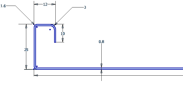

Example: Shelf size 1000mm x 300mm.
Taking a cut through the shelf and using inventor to calculate the Second Moment of Area, (I = 18654.4 mm^4) - this value is correct.
The edge of the shelf have extra folds - take as simply supported.
Maximum Deflection = 1000/100 = 10mm at centre of shelf
E=205 GPa
L=1000 mm
Result: Max shelf load from calculation = 299.38 KG

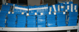

Sorry it was tested using a UDL, similar to below.

The image in post 3 shows the pin type supports. The section is constant throughout as in the image below, only their is a fold over the two ends as seen in post 3. Shelf size 1000mm x 300mm.
"does the shelf act like a beam, or something else?" - am trying to determine this. Think the shelf bends down in the centre due to it being light their, this is probably where most stress is. But I am most interested in finding the deflection along the edge?

How is your design depth-wise? It acts like a beam in this direction as well. Assuming your ends are not closed, the second moment of area in the other direction is 42.7 mm4 (= 1000 * 0.8³ / 12). With the equation above - assuming you have a shelf 300 mm wide X 1000 mm depth - the mass needed to get a 10 mm deflection would be only 25 kg. Even if the ends are closed, with the length, you can see the margin you have to play with.
If your shelf changes shape depth-wise under loading, it means the area for the second moment of area (length-wise) will change shape also (curved line towards the centroid instead of a straight line away from the centroid), thus affecting the second moment of area. Can it explain a factor of 1.9? I don't know, but it has some effect for sure (hence the use of a safety factor when «models approximately represents system»).

Think you are correct the I value will change due to the other axis deflecting. I have checked this and it will change as below.
I = 18654.4 mm^4 at start ---- now; I = 11300 mm^4 with centre deflecting worst case - which gives a load of 181 KG
The load above is closer but not exact...
