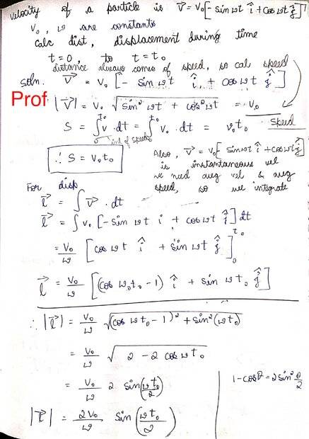

Velocity of a particle is ##\vec{v}=V_0\left[-\sin \omega t \hat{i}+\cos \omega t \hat{j}\right]##
##V_0, \omega## are constants.
Calc dist, displacement during time ##t = 0## to ##t = t_{0}##
##\vec{v}=V_0\left[-\sin \omega t \hat{i}+\cos \omega t \hat{j} \right]##
edit: I don't know why my latex isn't rendering, any help would be appreciated.
Edit 2: The question was due to a misunderstanding I had, I thought integrating instantaneous velocity would give me average velocity.

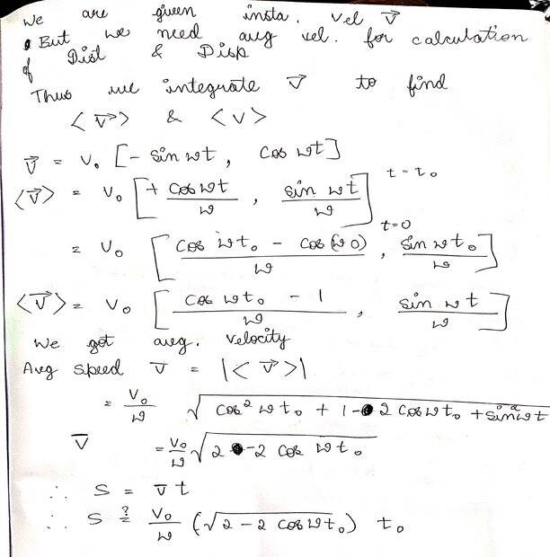

I have attached what I have tried so far. I had a doubt. Can you calculate the distance travelled by an object/particle using only the instantaneous velocity?
I mean, is the speed travelled by an object in time interval t = 0 to t = ##t_{0}##
S = ##V_{inst}*t_{0}##
My professor basically did this [Image with prof in it]
The other one is what I think the answer would be. I calculate the average velocity from instantaneous velocity by integrating ##V_{inst}## and then found out the average speed by finding the magnitude of the average velocity <vec{v}>
So, who is right? (I know I probably am wrong, but I want to know why)

You are asked to find a distance. Integrating a velocity gives displacement.
To find the distance travelled you need to integrate the speed, a magnitude, not a vector.
It just happens that in this case the speed is constant, so using the instantaneous speed is ok.

Slimy0233 said:
hey @haruspex why is the avg velocity same as instantaneous velocity here?
No, the average velocity is not the same as the instantaneous velocity. Velocity is a vector, speed is its magnitude.
Look at what your prof did: found the speed by taking the magnitude of the velocity.
$$\left.\vec{v}=V_0[-\sin( \omega t )\hat{i}+\cos( \omega t )\hat{j} \right]$$
$$\vec{v}^2=V_0^2[(-\sin( \omega t ))^2+(\cos( \omega t ))^2]=V_0^2$$
So the speed is constant, and the average speed is the same as the instantaneous speed. The velocity is changing, though, because the direction keeps changing. Over time ##\frac{2\pi}{\omega}##, the average velocity is zero.

Alarm. Speed has the same units as velocity.
