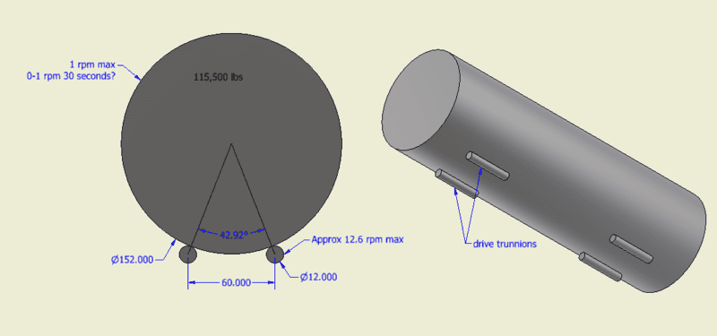

Hi,
I'm new to the forum so thanks in advance for any help. We would like to make a fixture for rotating large drums in a paint booth. I would like to know how to calculate the torque required at the trunnions to rotate the drum using two drive trunnions (with 2 idler trunnions). I've included a sketch with, hopefully, all the required info. It's been a while since I've done this type of calculating and can't find and specific examples. I'm more looking for HOW to calculate this not just necessarily the answer but the answer would be nice ;-)
Thanks again!

Welcome to PF.
There are two problems here.
1. The torque required to initially accelerate the drum to the required rotational speed will depend on the mass distribution in the wall and the ends of the drum, that is the moment of inertia. Will a drive surface slip, or will the torque be applied through some form of clutch or fluid coupling ?
2. The torque required to maintain that rotational speed.
The rollers may have roller bearings against the trunnions. Those bearings will have rolling friction, due to the weight of the drum. What bearings will be used?
If the drums are not balanced about the axis, a varying torque will be required to maintain rotation.
If the trunnion bearings lock due to a failure at speed of the drive system, will the drum climb the rollers, and so escape to roll free?

The mass is evenly distributed throughout the drum and it is empty when being painted. I did not plan to use a clutch. I'm not concerned if there is slip between the trunnion and drum but with the slow speeds it doesn't feel that would be a problem.
The trunnion bearings will be large PB Tapered Roller Bearings.
Thanks again.

Doh, sorry, I should have been more clear. Yes, we are manufacturing these drums and painting the exterior of them. We would like to be able to rotate them in the paint booth. The surface where the trunnion drives against is a large machined "tire" that will not get painted.

We've got the drum design down, been doing them a loooong time. No fear of deforming the drums, the tires are large enough, trust me! These are massive assemblies ;-)
Just trying to come to a required torque value on the drive trunnions to correctly size the drive components (motor/gearbox/coupling).

Please check the rotation rate of the drum against the separation of the rollers, to verify that safety will not be compromised by a drum escape, else the coroner may later want to examine your design notes and computations.
I was wondering about the flexible term "trunnion", which usually refers to a protruding solid round pin, that rests in a bearing, to support a body. It seems the term "trunnion bearing" has been reduced to "trunnion", and is applied in some industries to include the axle, bearings and roller that a drum rests on.
