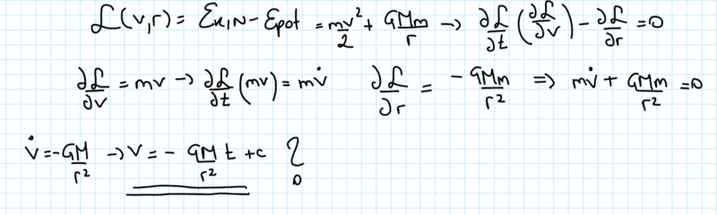

We were asked to calculate earth's escape velocity using methods 1) Newton law of motion, 2) Conservation of energy, 3) Lagrange method.
As to conservation of energy, that is clear, and I got the result (ca. 11.19km/s).
However for 1) and 3) I have no Idea, though I might have a start for 3).
Help would be appreciated.
Thanks

Note that the equation
$$m\dot v + \frac{GMm}{r^2}=0$$ is just ##F=ma##. You can't integrate it the way you did since ##r## is a function of ##t##.
How are ##r## and ##v## related?
Hmm I mean I know that r and v are related in a way that dr/dt=v and vice versa with the integral.
I could replace the v' in this differential equation you posted with r''.
That would give me a second order differential equation in terms of r, however, if I solve for r, I get a function r(t). How do I get a constant velocity out of this? By differentiating I get a function v(t), but I have no initial condotins to be able to compute v_escape.

I'm not sure what you are trying to do. Escape velocity is an initial condition at some initial ##r_0## in order to ensure that ##v \rightarrow 0## as ##r \rightarrow \infty##.

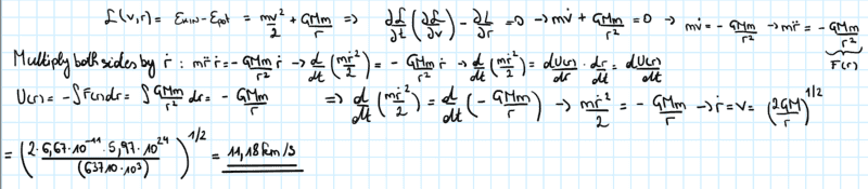

Hmm yeah that makes sense. Tbh I don't really get the question we were given either. It said that we must calculate escape velocity using the Lagrange equation, that's it. But yeah, I will try to find a way, maybe some idea pops up.

The usual trick is to multiply both sides of the equation by ##\dot r##, which makes it easy to integrate. You should recognize the resulting equation.
Thank you for the hint, I had totally forgotten about that trick. I think that made it work:)
