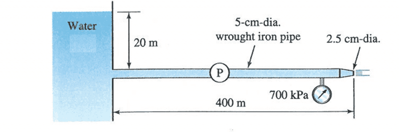

In summary, the pump in the system below has an efficiency of 75%. The atmospheric pressure is 101 kPa and the vapor pressure is 2.3 kPa (in absolute units). Assume kinematic viscosity is 0.96x10-6 m2/s. The velocity through the main pipe and of the jet are 9.66 m/s and 38.64 m/s, respectively.

The pump in the system below has an efficiency of 75%. The atmospheric pressure is 101 kPa and the vapor pressure is 2.3 kPa (in absolute units). Assume kinematic viscosity is 0.96x10-6 m2/s. Neglect minor losses.
a) Calculate the velocity through the main pipe and of the jet
and a few other questions to do with friction factor, etc.
AV=AV
v^2/2g + P/pg = v^2/2g + P/pg
Have been given the answers but no working. – 9.66 m/s for pipe and 38.64 m/s for jet
First used AV=AV to get
v_2 = [(d_1)^2/(d_2)^2] v_1
Then I put this into Bernoulli with the relevant pressures P_1 = 700000, P_2 = 101000 but I only manage to get v_1 = 8.94 m/s.
I have tried working it with elevation head but still can't seem to get the right answer. I am thinking maybe I should have pump head? But not too sure how to calculate with what I have been given.
My immediate thought is that 700kPa is a gauge pressure.
The 20m head provides pressure at the other end of the pipe - which should tell you what the pump is doing.
It may help if you think of the pump as replacing a drop in height.

Thanks that helped get it sorted, changed my P_2 value and found the right answer

They are parts b,c,d when they want the friction factor, pump power and distance from reservoir to avoid cavitation. I can't seem to solve the NPSM but will keep trying.
Yes. I looked over the problem again, and Simon was right regarding the gage pressure (as your answer confirms). You next need to calculate the Reynolds number for the flow in the pipe. This will then allow you to determine the friction factor.
