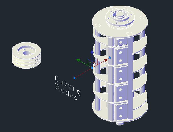

My machine is to cut tree branches.
See attached photo.
The hydraulic motor is not shown.
The fly wheel has steel blades attached to a turning "steel cave".
This structure is turning by an hydraulic motor and pulleys and belts.
The hydraulic motor maximum speed is 750 rpm, torque is 19.5 Nm power is 12.5 W.
My idea is to have pulleys that will turn the "Flywheel" at around 2.000 rpm.
I already tested this speed on the real flywheel and there is no vibration ( it is well balanced).
My idea is to make the flywheel turn up to maximum speed of the gear motor, and the to feed it the tree branches that will cut them in little pieces (chips).
Each revolution will cut a small part ( chip) of the tree branch, and will reduce it speed.
If the branch is too strong ( stronger wood or bigger diameter) the flywheel will reduce the speed.
When the "machine operator" finds that the speed is too slow, he will deduce the velocity that he is feeding the branch .
Outside diameter of the flywheel is 300 mm and its weight is 58 kilos ( 580 N).
Well, I believe it may work: what do you think?
Thanks a lot for all your help.
Hans

Commercial wood chippers are on the market. you might want to look at one of them.

When building a machine that has the same function as commercially available machines, it is good practice to take a look at similar machines, then design around their weaknesses. A commercially available chipper with about the same power as your 12.5 Kw hydraulic motor is: https://www.drpower.com/power-equipment/chippers/wood-chippers/self-feeding-wood-chipper-16-5.axd. If the chipping head has enough inertia, it can be direct driven by the engine.
Larger chippers automatically vary the feed rate to get maximum chipping speed. One of these will chip an entire tree in a few seconds: http://www.morbark.com/equipment/3036-whole-tree-chipper/#1365620863249-5-4.
MTA: Dr D beat me to it... In what way is your design better than the commercially available chippers?

I'm still seriously concerned with safety. As those blades hit the wood, they will enentually break sending sharp,pieces of metal flying. Suppose there is a nail in the wood you're cutting. Then the remaining wheel will be seriously unbalanced. It might throw off more blades. Your machine needs heavy duty shielding to contain any flying bits.The slower the RPM, the safer. Why do you think you need such high speeds?
Here is a wood chipper that sounds close to,your description. Rotating disc 434 kg, 4 knives, 250 hp engine, no data on RPM.
http://www.scanwood.co.za/downloads/TP_320_Data_Sheet.pdf
