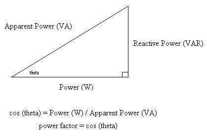

Sorry to throw you in the wrong direction. 15kw is correct.
If you can remember trigonometry, that is the reasoning behind maths that applies here, as per the 'power triangle' (attached).
